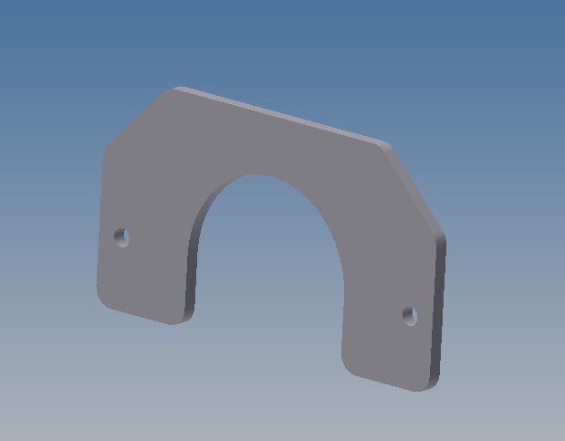

    I was thinking about using a 1/8" or 3/16" cable wrapped around the CV inner housing and connect it to a good sized slide hammer, which is a combo of your method and a slide hammer. What do you think?

    I've come up with an idea to work with a 5 lb. slide hammer instead of using a cable wrapped around the CV housing, which is with the CV shaft pried out as far as will go, a 3/16" steel plate can fit in the opening and which will bear against the surface on the inner CV housing. The holes in the plate are just wide enough so that the cables or threaded rod will clear the inner CV housing and the rubber boot
    So I took measurements and drew up a simple plate with a close fitting slot in it with a couple of holes for either connecting two cables to or two threaded rods to. Then the cables or threaded rods will connect to a plate that the slide hammer shaft will connect to. This should work well for popping out the CV shaft.
    CenCal805 and smitty99[QUOTED] like this.
