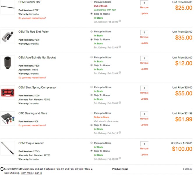

    So i figured id share my experience. I am not super mechanically inclined but I am very well read on the subject and watched a ton of youtube videos beforehand. I lifted my 2016 sport a few months ago and got the vibe. Toyota did not have an answer so they replaced the whole front diff which solved the problem for about 2k miles. I finally grew the balls to do it myself.
    I used these youtube video as my guide
    CV axle removal video
    https://www.youtube.com/watch?v=ZfpP4sy8qYw&t=226s
    ECGS needle bearing removal and ECGS bushing install video
    https://www.youtube.com/watch?v=WnA_R3gFf2s&t=200s
    I rented most of the necessary tools from autozone loan a tool program (I can not overstate the importance of having the right tools and it doesn't cost anything to rent from autozone (100% refund with return of tools within 90 days))
    heres a list of what i rented
    35 mm socket
    breaker bar
    torque wrench
    tie rod separator
    bearing driver kit
    263 dollars total shipped to my house for free and 100% refundable if you return the tools within 90 days which I did today
    (The spring compressor was for something else and is not needed FYI)
    Some other tools I had that were necessary
    Pry bar
    10 mm allan wrench on a socket driver
    ball pien hammer
    small sledge hammer
    jack stands
    jack
    standard set of sockets up to 22mm
    I bought the $60 needle bearing puller tool and in my opinion it is a must
    I used the ECGS recommended gear oil afterwards which i ordered from Amazon (85W-140)
    https://www.amazon.com/gp/product/B000IG20T0/ref=oh_aui_detailpage_o01_s00?ie=UTF8&psc=1
    Used this forum for a guide of torque specs for reassembling everything
    https://www.tacomaworld.com/threads/the-torque-spec-guide.318116/
    All in all it took me about 4 hours and keep in mind I've only driven about 20 miles since the install but my taco drives like a dream now. Quieter than the day I bought her. Hope this helps anyone with any doubt about doing it yourself. The two hardest parts were seating the removal tool behind the needle bearing and the other was pounding the new ECGS bushing in.
