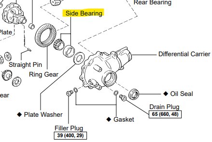

    seems like my front drivers cv axel has some play in it. I've been looking at many different threads about replacing the needle bearing and I think its something I can do. https://www.tacomaworld.com/threads/front-differential-side-bearing-replacement-done.130558/page-2
    But I cannot for the life of me find the replacement part. Needle Roller Bearing - 90364-35010
    This one only fits 2005s and newer. If anyone has done this before or seen anyone else I would really appreciate the help. For context I have a 2001 TRD ext. cab. Let me know if I can clarify anything too.

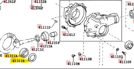

    Other than the seal- these would be the only bearings I can see from the diagrams:
    90368-50006 / 41311A (Differential Carrier Bearing)
    41311B looks to be a shim of some sort. The reference number has more than 25 different part numbers associated with it: 90564-50092 - 90564-50118...

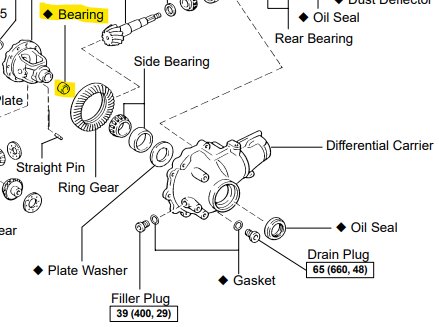

    So not the needle bearing? and isnt the differential carrier bearing for the differential and not the CV axel? everything Ive researched so far has pointed me to the needle bearing.

    That thread you referenced was for 2nd gen trucks. They don't overlap many (if any) parts.
    I couldn't tell you for sure that it is or isn't the bearing in that diagram- but the diagram doesn't have another bearing there.
    I'd pop the CV axle out and just do a visual on everything. Are you running OEM axles or aftermarket/parts store replacements? If it's a parts store axle, and it has a warranty it couldn't hurt to just get a new one.

    The bearing in question, the one that gets replaced by the ECGS bushing is shown in the diagram. From your text "Other than the seal", follow the line directly under "Other than".

    Well, in that case:
    41331G / 90364-33009 (Differential Carrier Bearing)

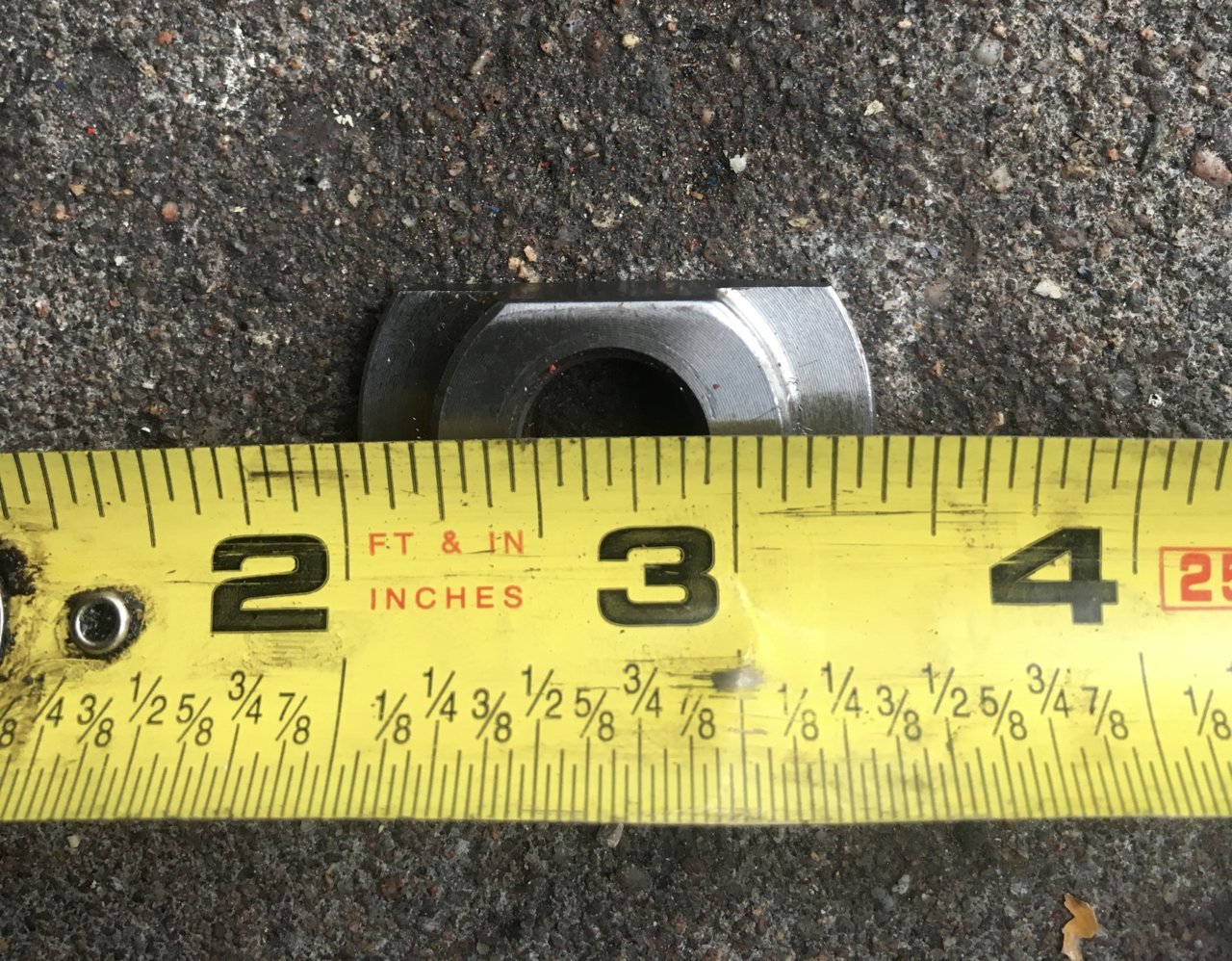

    Ok well I'm not sure when ill have time to do the swap, so feel free to give it to someone else. Any chance you know the outside diameter of the tool? been thinking of just making one.

    Not off hand. I can check & get back to you later. I seem to recall something about 7. CM?

    Or maybe it was a 5…. Hmmmm….
    5 1/2 cm. I think it’s on the ECGS site, if you wanna double check, because there are two sizes. One for us & the other for 2nd & 3rd gen.

    awesome! just what I needed thank you.
