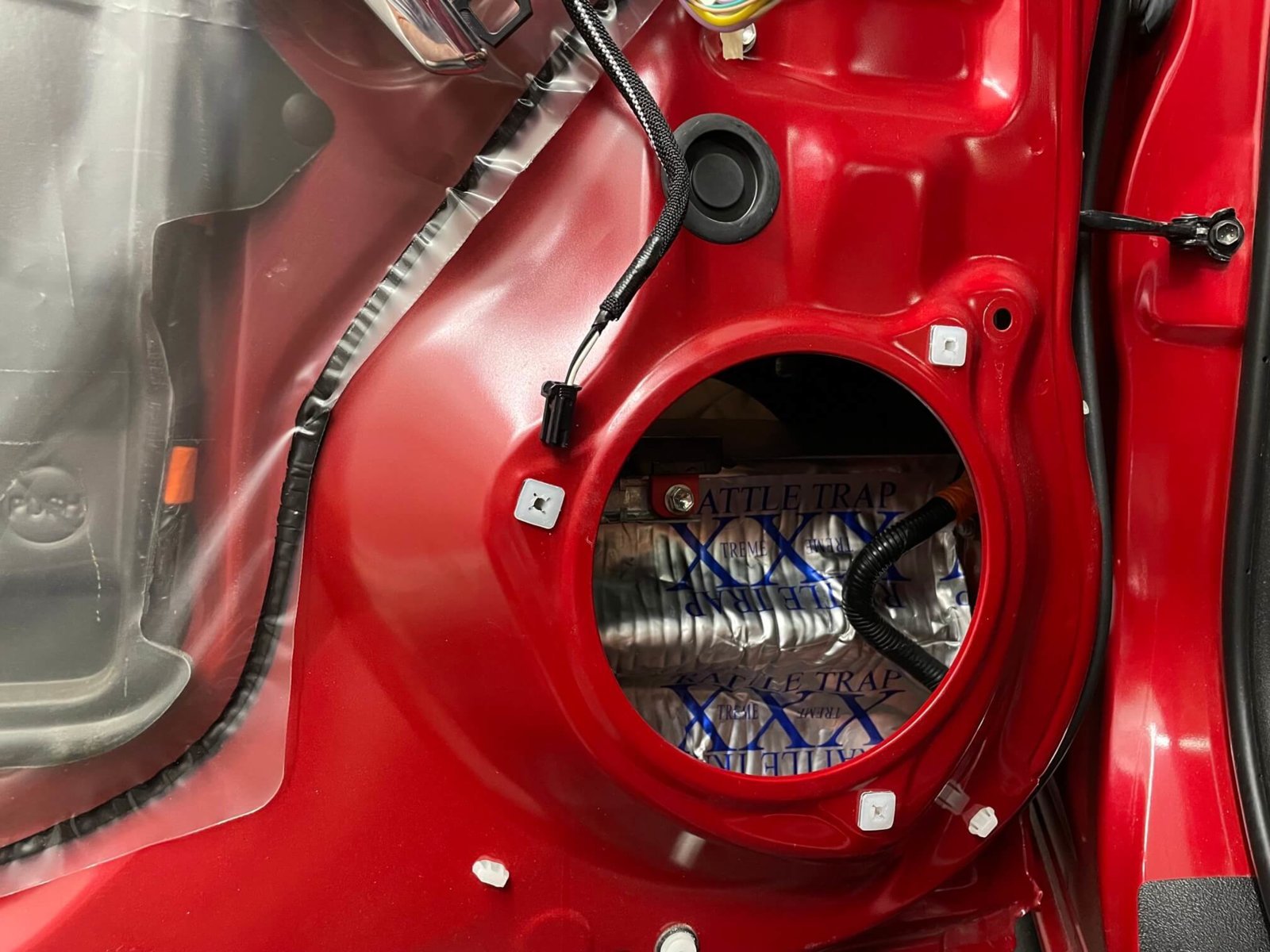

    Sound deadener inside the doors (used Fat Mat Rattletrap) really helps with low-end sound and is really easy to do while you have the speakers out - peel and stick. A powered sub would help even more. But then again, once you start down that road it can cost more than just replacing the head unit with one that has a good amp, etc.

    Great post! Where exactly would the deadening material go? TIA

    The deadening material works best on the inside skin of the doors. Some just put it behind the speaker opening, but it's fairly easy to stick it to most of the inside of the door by reaching through the speaker opening in the door. Forgot to take photos of the front door, but here's how it looks in the back door.
    Keep in mind that you don't want it to interfere with any of the mechanics inside like the power windows, etc. If you feel around in there, with the window in the down and up positions, you can tell where it should and should not go. For the Taco there's a lot of clearance though.
    FWIW, there are a bunch of threads on the forum that show what other folks have done and what they recommend if you do a search.
    EDIT: Earlier I mentioned my go-to sound deadener, FatMat Rattletrap. Just looked and their prices have gone up quite a bit. I've been happy with Noico Sound Deadener which is cheaper. I think Amazon has a house brand too but I've never used it. I've always used 80 mil. It's easy to cut the material up with a sharp box cutter. Doesn't really matter how neat it is as long as you're covering the metal surface. No one's probably ever going to see your work. ;)

    Agree with adding sound deadening, I did, but not for improved radio sound, but for just the closing of the doors sounding not so tinny. I will do the same to my remaining vehicles whenever I have their doors open again.

    Agree with adding sound deadening when you have the panels off. It definitely makes the doors feel nicer when they close them and the bass seems better. But I'd do it again if for nothing but the better feel of the doors. Make sure to put some around the handles, it makes them feel solid.
