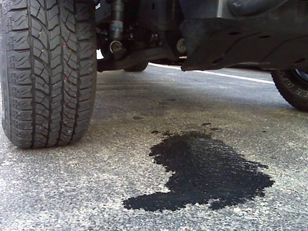

  15. Dec 28, 2010 at 8:00 AM
    #35
    GOLFMAN845
    GOLFMAN845 Well-Known Member
    Nov 11, 2010
    #46030
    58
    Nic
    2002 Black Double Cab 4x4 TRD
    Leather Interior, Hunter Bull Bar with 4" KC Driving Lights, Black Pro Comp 16" Alloy Wheels, Yokohama ATS Tires, OME 881 Coils with Bilstein 5100's set at 1", Rear Dakar Leaf Springs with Bilstein 5125's, Removed Rear Decals on Bed
    Well I replaced my front axle's Sunday drove it back to St. Louis last night, then came out and found this morning.
    I am going to take it back apart tomorrow and put in a new Output Shaft Seal in it. Will probably do both sides, just to be safe.
