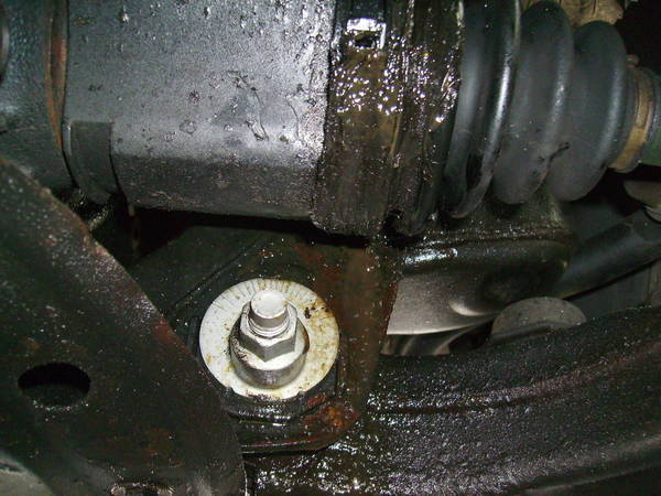

    The pic above is mine, taken a few months ago. After further inspection I'm not sure it was a leak at all. I simply cleaned it all up really well and there has been zero grease in that spot since. (Hopefully there's some grease still left inside the boot! :eek:)
    Id suggest you clean it up well, THEN look for the leak before you go replacin stuff.
