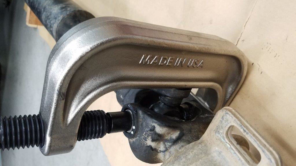

    The ball joint press is the way to go on u-joints- especially if you have an impact gun. I have an OTC but Astro makes a nice one that's cheaper. I had a HF one prior to the OTC but it was a POS and I finally scrapped it a few yrs ago

    This is what i used. My battery impact wrench didn't have enough torque... My 24in breaker bar did.
