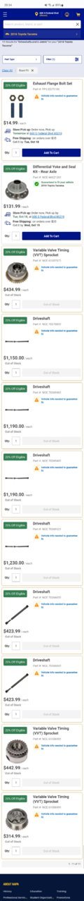

    When I click on your link, it just brings up some random parts (see attached)

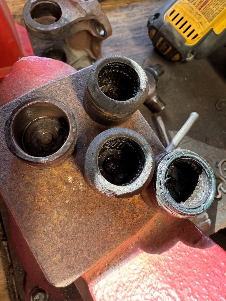

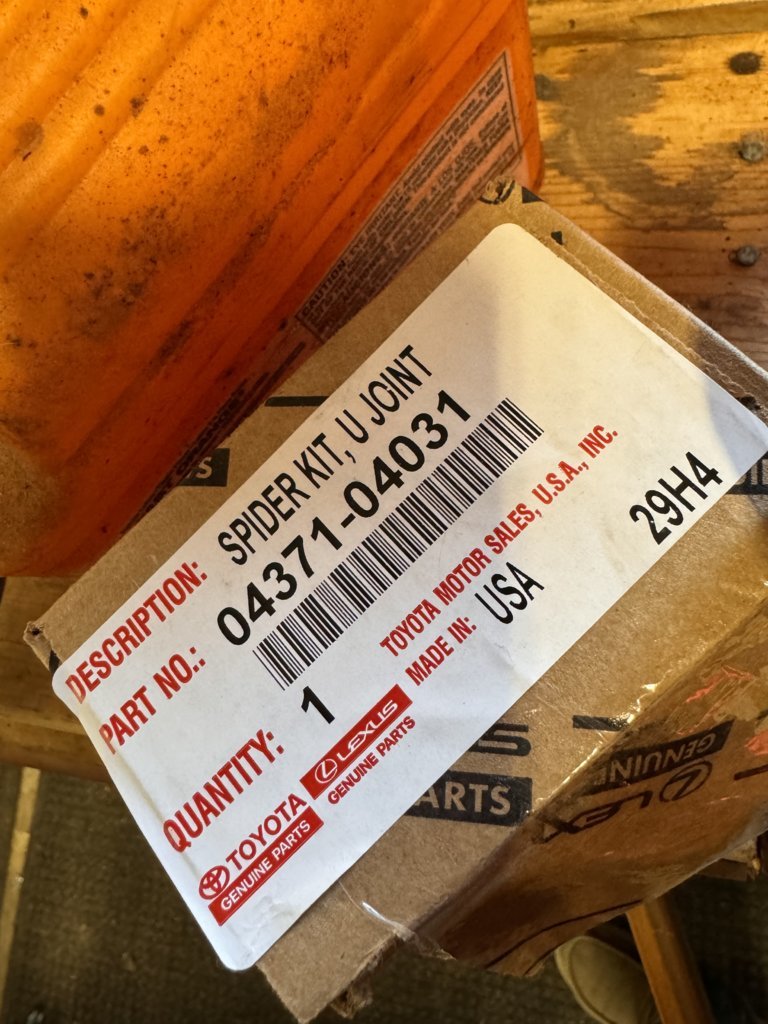

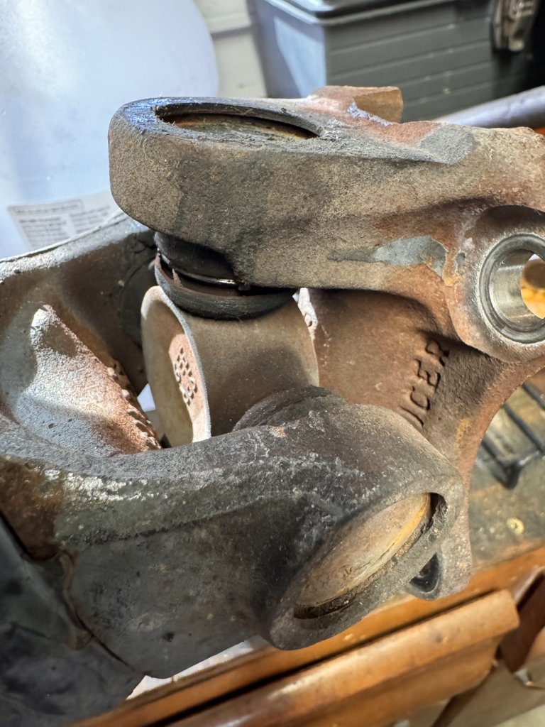

    After turning 300k - I started getting a vibration while on the loud pedal. Crawling under my rig and inspecting the driveshaft revealed the U-Joint at the transmission w play. I searched the parts stores, there is no listing for a 3rd Gen. I ordered a spicer 1310 and 1350 stated in this thread but got worried and ended up ordering the OE part. Dropped the driveshaft, marked the position on the yokes w a gear indexing pen. Used my ball joint press and a hammer, 30 mins later the new U Joint installed, vibration gone and I’m good to go. It was a very install repair.
