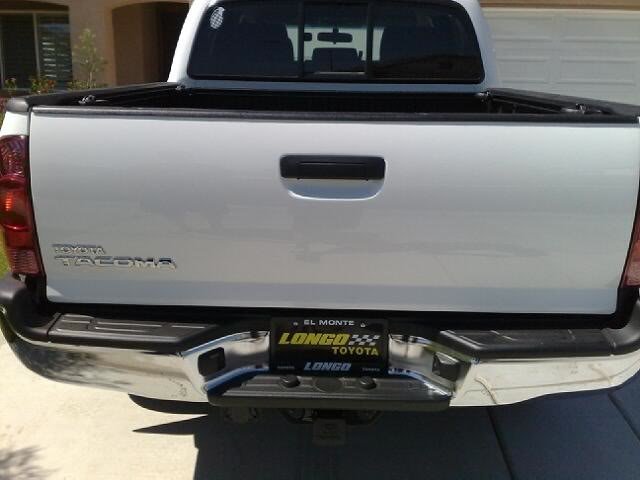

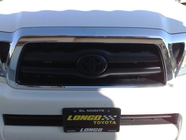

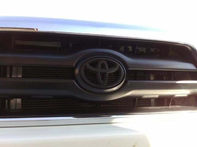

    To update this thread, Here are some pictures of my blacked out emblem that I did today. Also I debadged the 'V6 SR5' on the tailgate
  12. Sep 24, 2008 at 8:22 PM
    rkdiddy
    rkdiddy Senior Member
    Jul 26, 2008
    #8152
    63
    OC Baby!
    '08 Taco DC PR
    Looks good - welcome to the club! :)
