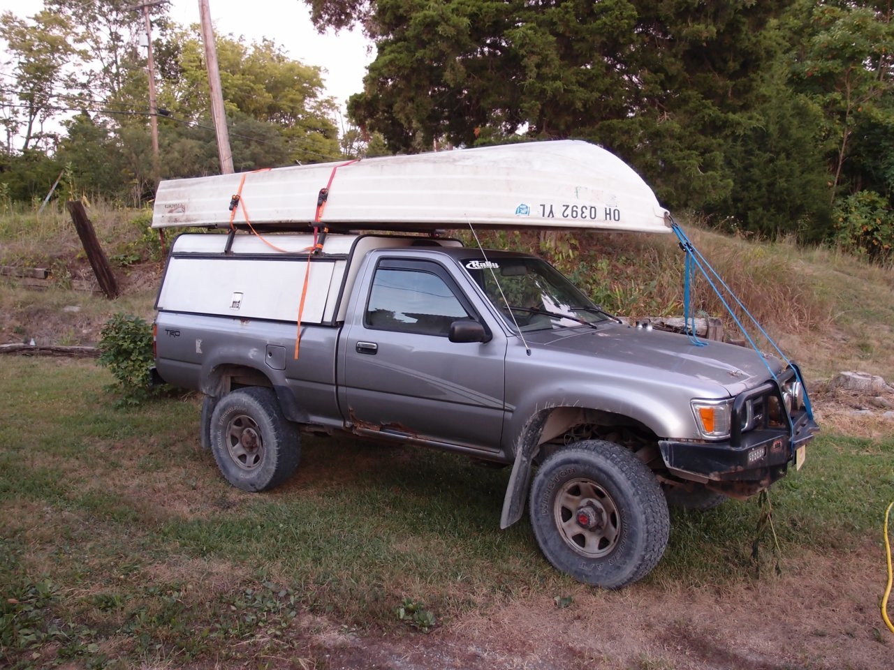

    I have a 2017 TRD Sport access cab that I occasionally carry a 17' Grumman aluminum canoe on (75 lbs.). I have a hitch mounted rear support that works great for the back end. Since I don't have a roof rack I used a couple of jumbo pool noodles split down the middle and snapped over the gunnels to ride on the roof. This also works great for the time being. The trouble is that I want to avoid my front tie downs from actually rubbing on the front edge of my hood and bumper to avoid wear. I was thinking of a taller bull bar as that might be high enough and extended out enough to tie off to while avoiding contact with the hood and bumper. Does anyone have any other examples or ideas of how I might accomplish this? I have no intentions of buying a whole new front bumper setup. My serious off-roading days are long past so my truck is basically a Michigan commuter that I use for my hunting, fishing, and light camping duties as well. Budget is a definite concern. I'm not looking for any smartass answers just some realistic suggestions. Thanks in advance for any help.CANOE SETUP.jpg

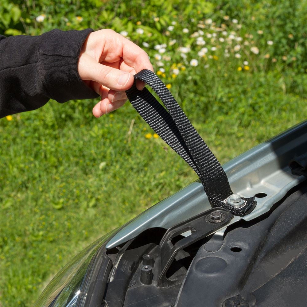

    Are you using hood loops on the front?
    wahoobie, Bleep100 and BassAckwards like this.

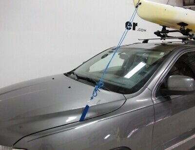

    I would use hood loops; either bolt-ons or the temp ones.
    I use them on our Forester;
    With the Tacoma I have it tied down good enough on the Prinsu that I go without a front strap.. I use Malone gunwhale brackets.
    In the past I've run one up over the grille, but only because I had the lightbar to attach to;

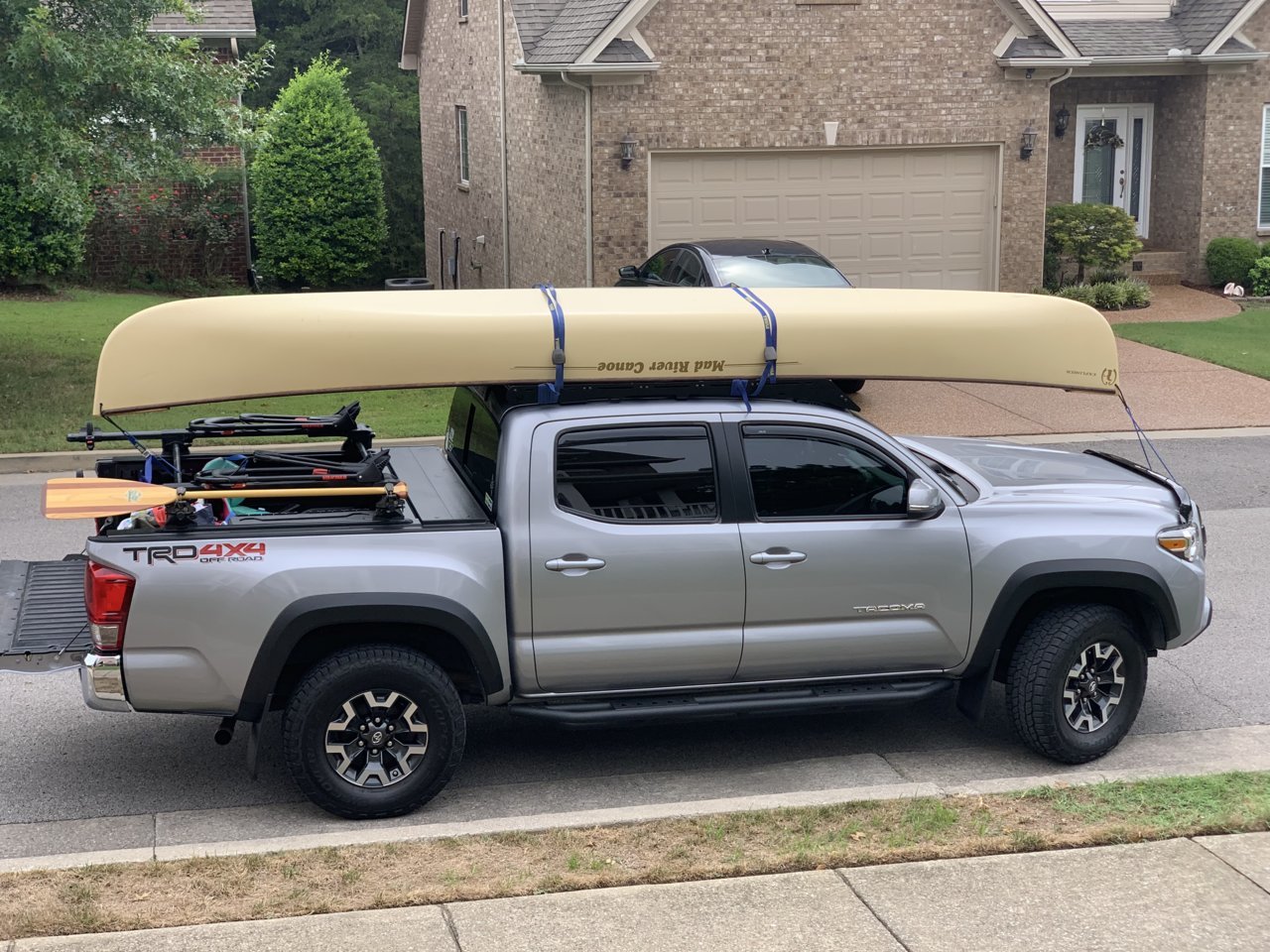

    I've got a 16ft old-school royalex. Not that heavy by any means, and I wouldn't dare try to put that on a basically bare roof. you can get some cheap bars for the roof so you can get a solid tie down point up top and raise it up a bit higher. Then a simple ratchet rope in front on your stock recovery hook will prevent sway of the canoe. I was worried about rubbing of paint on the front of my truck as well but after several, often several hour trips with ours strapped down there hasn't been any rubbing. I just make sure it's good and tight so it isn't wiggling around on there and have had zero issues...

    I like the idea of those hood loops. My last two Toyota trucks had full toppers with permanent racks on them for the canoes. Everything else I've had in the last 30 years had full factory roof racks.
