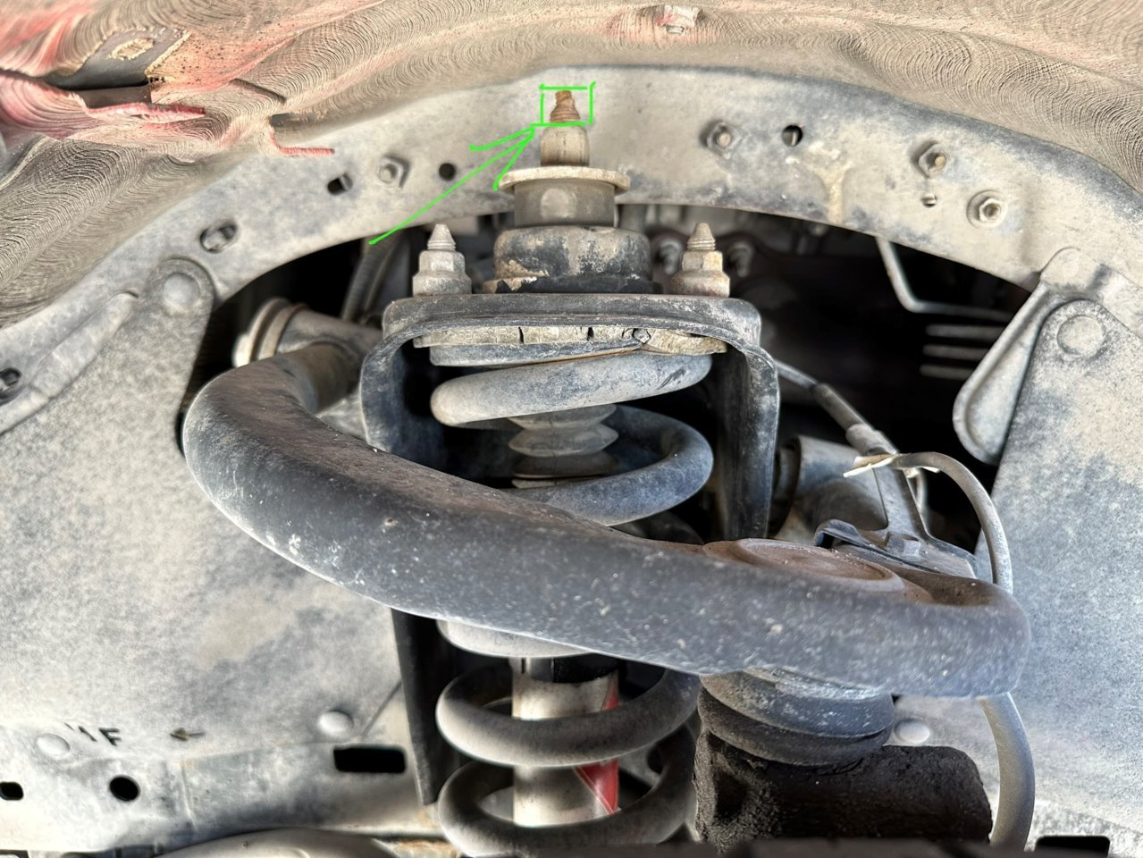

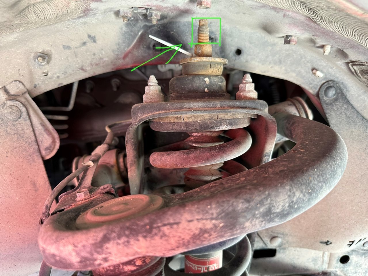

    Tried standing and rocking in the door sill today to see if I could pinpoint the clunking on the front driver's side. I noticed that the bolt, washer and rubber bushing on the shaft of the strut was moving! I tried tightening it down with a wrench, but the shaft in the coil just spins... The amount of threads on the driver's side compared to the passenger side is drastically different, as seen in the photos. Maybe the valving is just worn on this particular strut? Or maybe there is another way to tighten this down? There is fluid around the boot on this particular strut, so maybe it's just time for replacement?
    First photo is the strut in question that has movement
    Second photo (more red in the photo) is the strut that doesn't have any issues

    Any help would be much appreciated!

    Clamp and hold the top of the bolt with visegrips then tighten the nut with a wrench

    To me, it looks like the strut isn’t tightened to the hat. Look at the bushing compression on the passenger side. Then look at the driver and the lack of compression. The length of exposed thread is also a sign.
    There is actually a tool for this which prevents distortion that may keep the nut from being removable.
