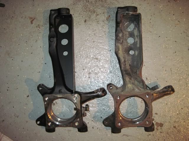

    The spindle on our trucks is the piece that connects between the upper and lower control arms on the front suspension. Holds the brakes, bearings, and wheel in place.
    Most accessible pic I have of a spindle is the old bent vs. new gusseted one from my truck:
    Lift spindles work for 2wd trucks by shifting the mounting point of the brake/bearing/wheel assembly down 4 inches. Clever trick and they work very well.
