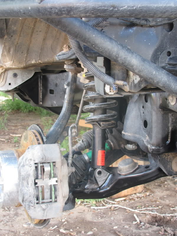

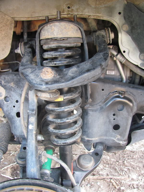

    got the pics. they arent verry good. i couldnt see how the top of the shock mounts so these are of the bottom. all the pics are drivers side.

  20. Jun 20, 2012 at 10:05 PM
    #20
    white toy taco
    white toy taco 505 Member
    Dec 23, 2011
    #69296
    1,925
    Albuquerque, NM
    '06 OR and '02 OR (sold)
    oh yea there not the same at all. heres mine (there is supposed to be a bolt running through the bottom of the shock obviously)
