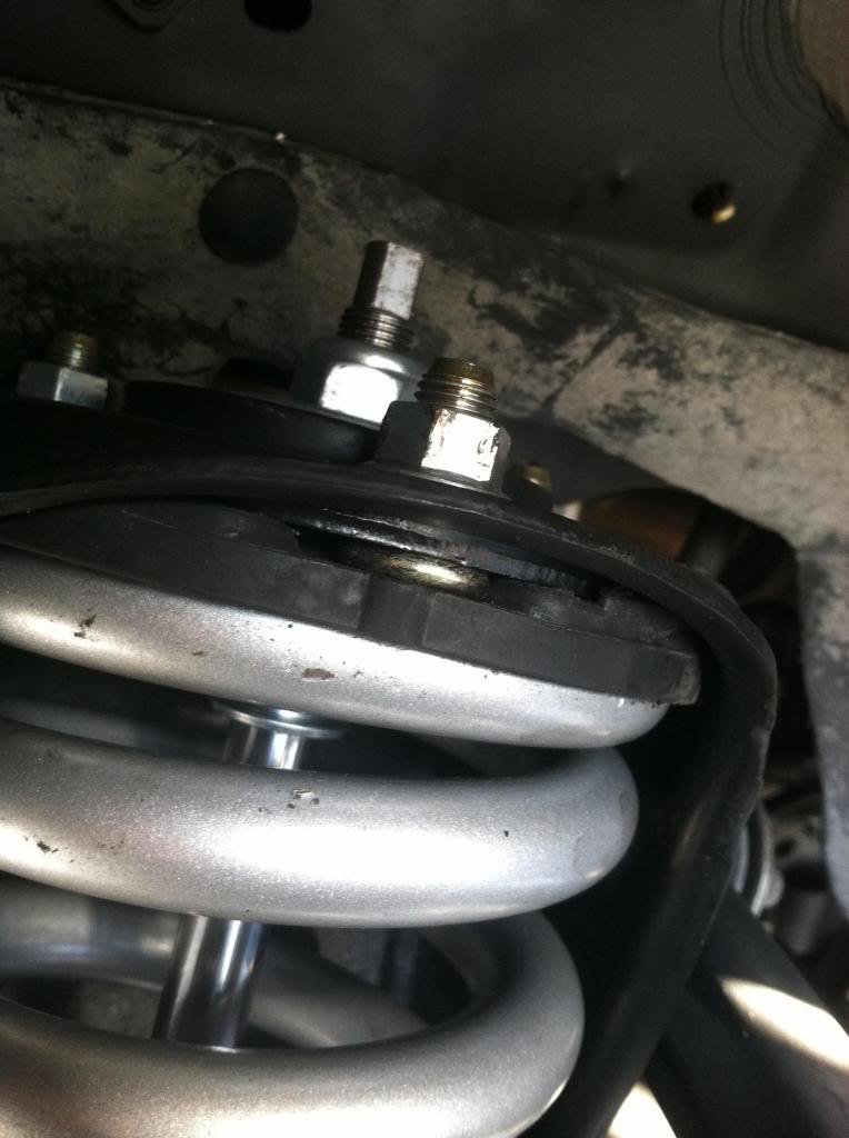

    Crappy iphone pictures in the dark:
    Is that gap between the isolator bushing and top plate too big?

    That isolater block should be right up tight against the top of the shock tower. I'd bet that's your rattle. Can you tighten the 3 nuts on the top any more?

    I got like half a turn out of the closest one here

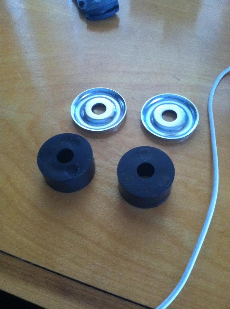

    But I just remembered I have these bushings and washers that I thought were extra...
    Now I feel dumb. Where do these go?

    Those go on the underside of the top plate.

    Hmm... My isolator block sits right up tight against the top of the tower. I haven't seen that setup before :confused:
