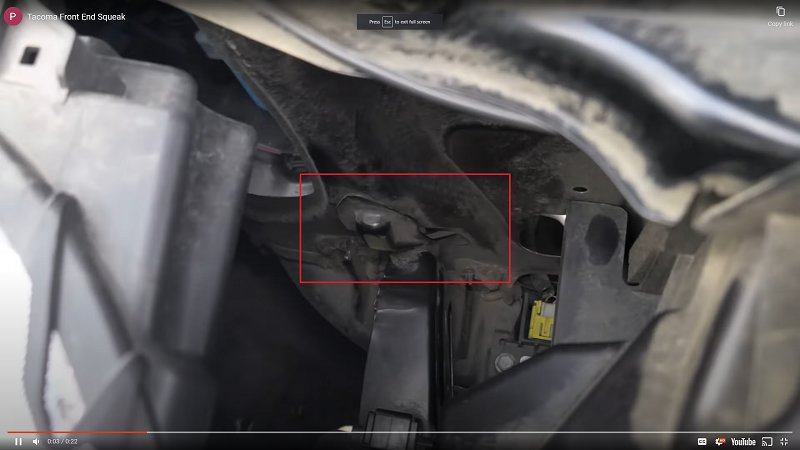

    where on the truck exactly is that red located

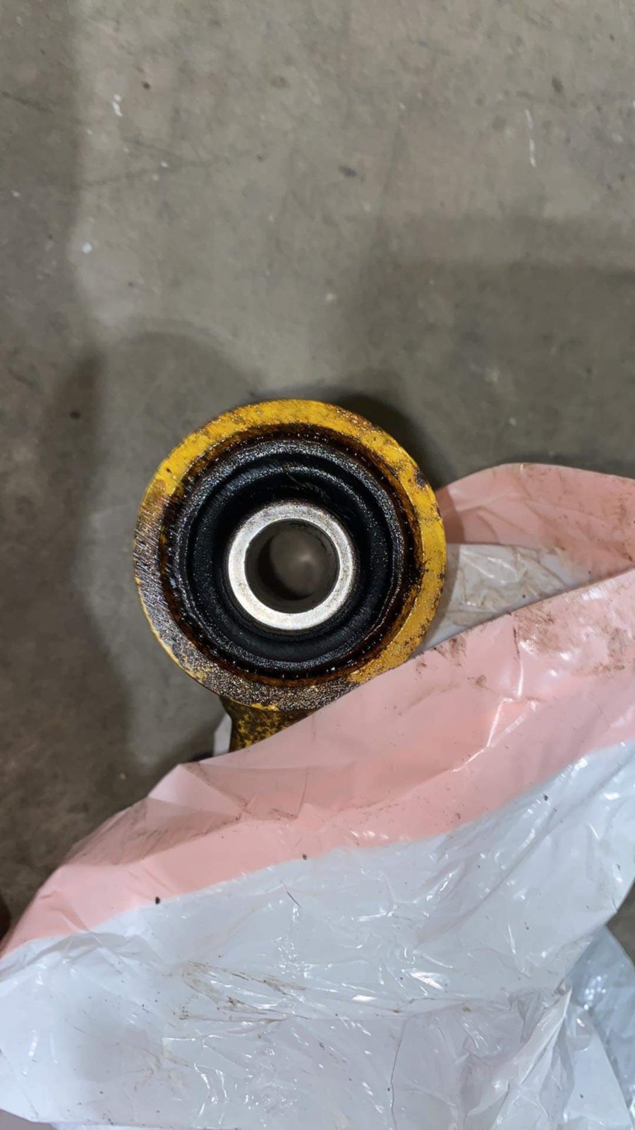

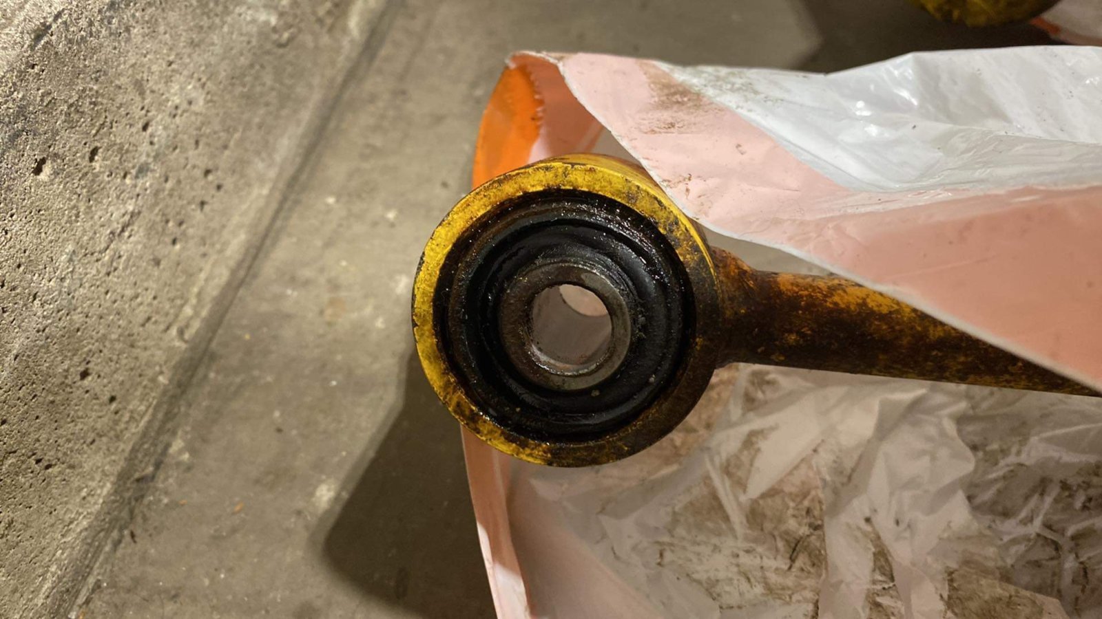

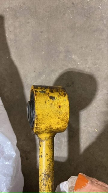

  16. Nov 28, 2023 at 2:24 PM
    #16
    Buzzkill657
    Buzzkill657 Well-Known Member
    Feb 25, 2018
    #245519
    299
    Jeff
    If anyone is interested, I may have found my squeak.
    from the looks of my lower shock bushings I’m guessing that’s my problem. Won’t know for sure for a week when I have time to get the new ones back in.
    also debating on wether to do my lower control arms while I’m there. I bought new ones thinking that was my problem and found the shocks when I was tearing it apart

    Replaced the shocks and noise is gone
