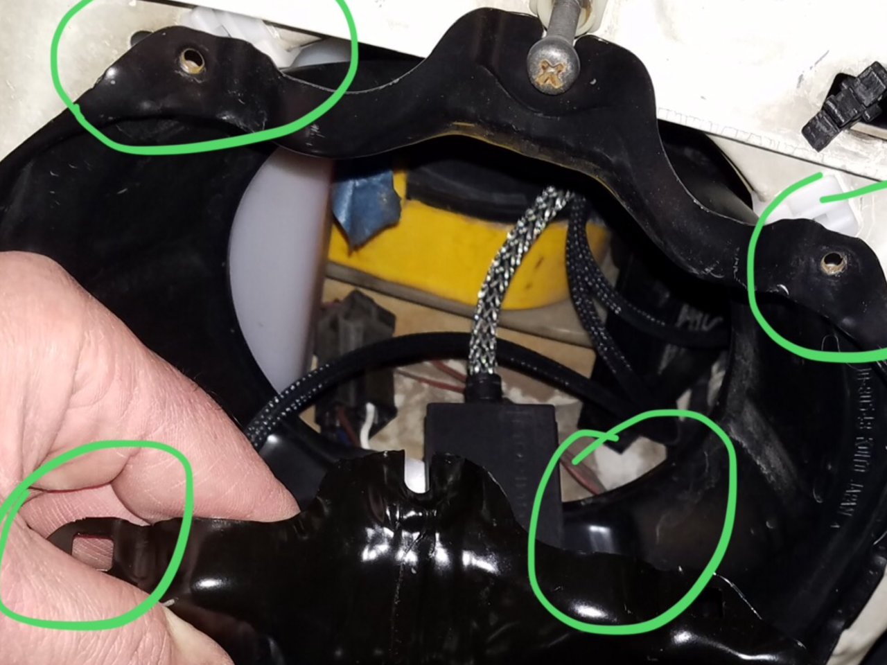

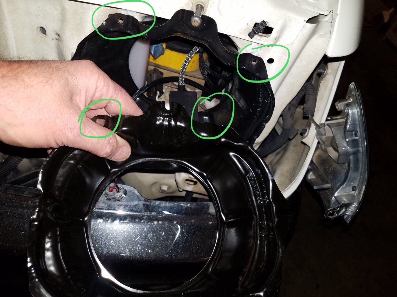

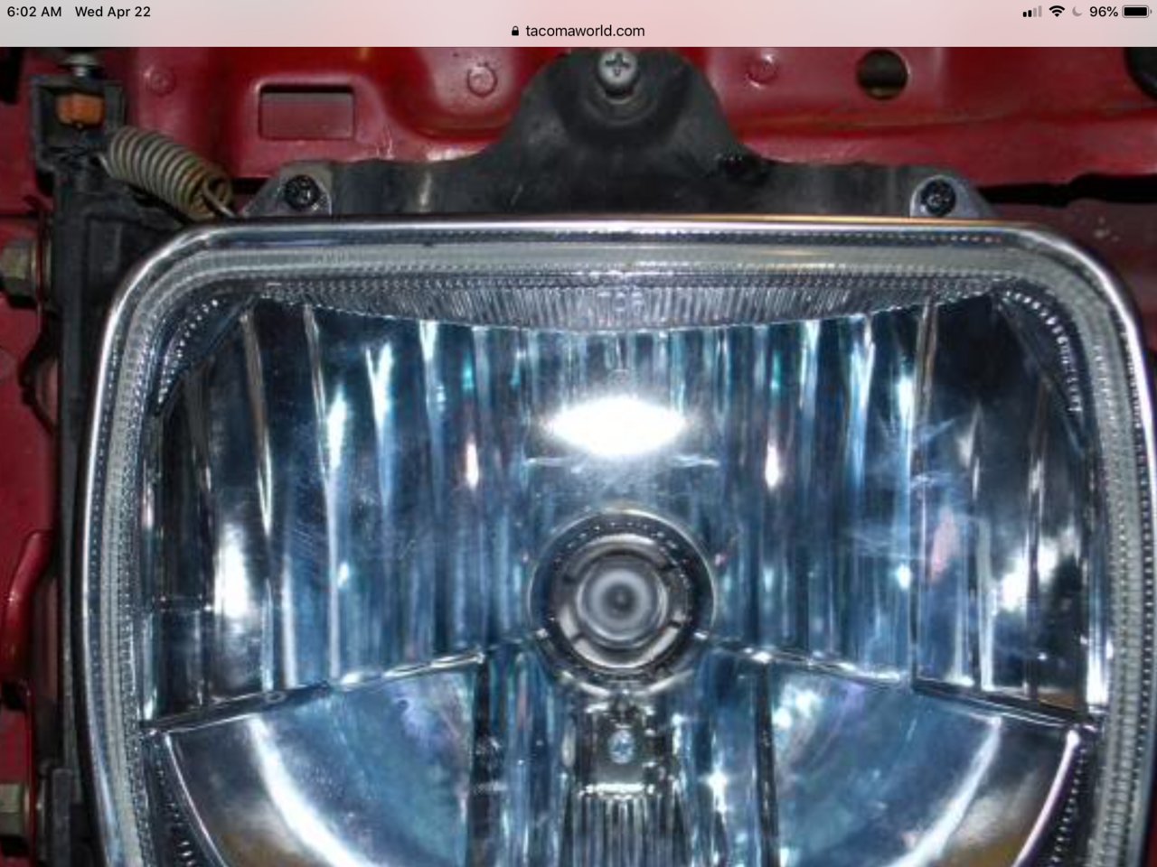

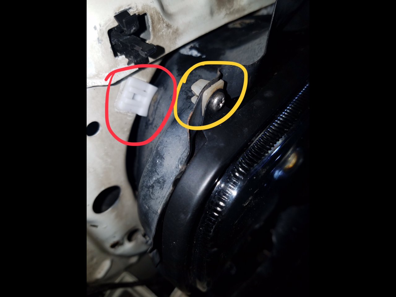

    Where did you get the metal headlight buckets from?
    Apparently there are two design types that were made that either had a square cutout
    with a plastic tab insert for a screw to hold the glass light housings or just a screw hole.
    I wasn’t able to find the bucket for the right side that had just the screw hole.
    Both original came with the square cutouts, but the plastic inserts tab to hold the glass lens
    is not available.
    You definitely want the metal headlight buckets that just have a small hole for a screw
    instead of the square hole design if you can find.
    Did your buckets have the square holes needing a plastic inserts or just a small screw hole?

    I bought the headlight buckets off a guy parting out his Tacoma here on TW. Can't remember which ones they were. Pretty sure they were the ones with the holes for screws as that's mainly what we used to secure it down.
