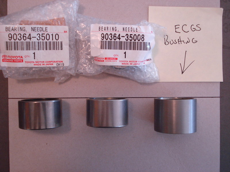

    +1 ecgs bushing. made such a difference, just wish it were easier to change(ok i wish i had done it when i was doing lift)

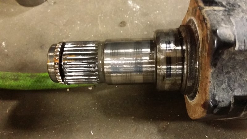

    Note the shiny spots where the bearing rides on the axle. That was less than 10k of driving after lifted. The needle bearing had considerable play, didnt measure but id guess easily .010 vs maybe .001 on the ecgs bushing. If the warehouse were open while i was doing the job j wouldve replaced the axle

    What size bearing race did you use for the install? Trying to save a few and just buy the size i need for this, instead of the whole kit

    Damn, you just made me order the bushing with that pick. I have noticed it but have been putting it off with the cold/snow, now will be finding time and doing it over my next 2 weeks off.

    Disregard I found the tsb for the fix, unfortunately they use same size needle bearing with smaller inner needle bearing inside don't know this would help because it's not long enough to support the cv shaft...

    Nope tsb is a longer bearing but same ID afaik. Ment to support better which it might but it isnt enough
