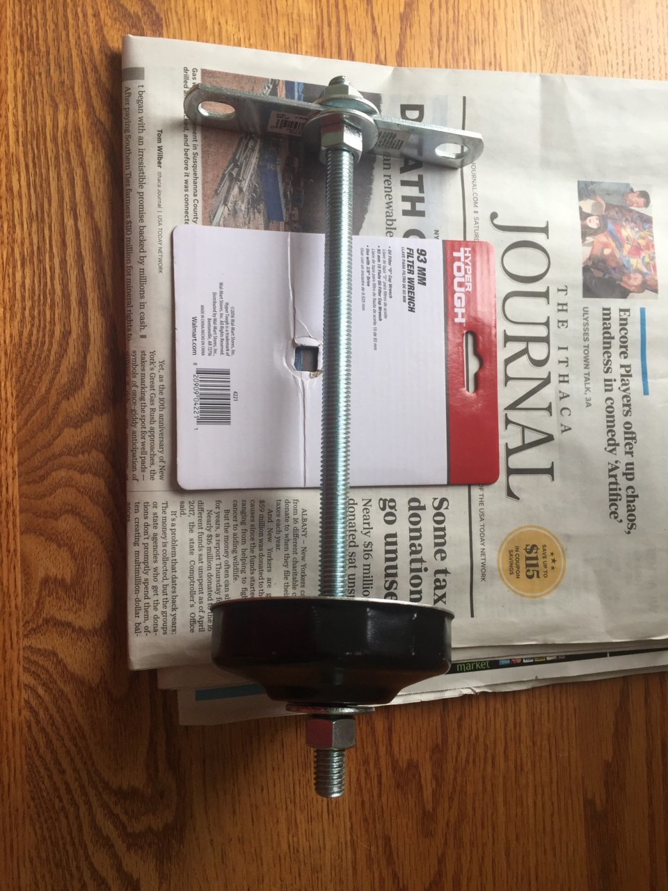

    BBA5565B-A020-4685-BA9C-3210E772872A.jpg I made this tool to replace front inner dust seals with the following materials purchased at Tractor Supply Company and Walmart for less than $9 :
    • Threaded rod 1/2” x 12” (TSC) $2.49
    • 3 @ 1/2” nuts (TSC) $0.33
    • 3 @ 1/2” washers (TSC) $0.33
    • U-Bolt plate #2191 3/8” x 4” (TSC) $1.49
    • Hyper Tough 93mm oil filter wrench (Walmart) $3.37
    Drilled 1/2” hole in center of u-bolt plate and filter wrench.
    Assemblied parts.
    Filed oil filter brim for slightly looser fit.
    93mm perfect fit for the Timken #710573 (OEM 90316A0001) purchased at Rock Auto for $8.21
