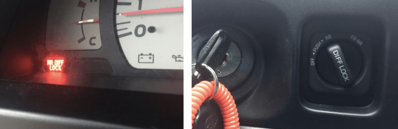

    What are you guys using for a front locker switch?
    I was thinking of maybe an OEM rear locker switch, in order to fill the spot where the clutch cancel switch normally goes.
    Ordered a Harrop front locker last week.

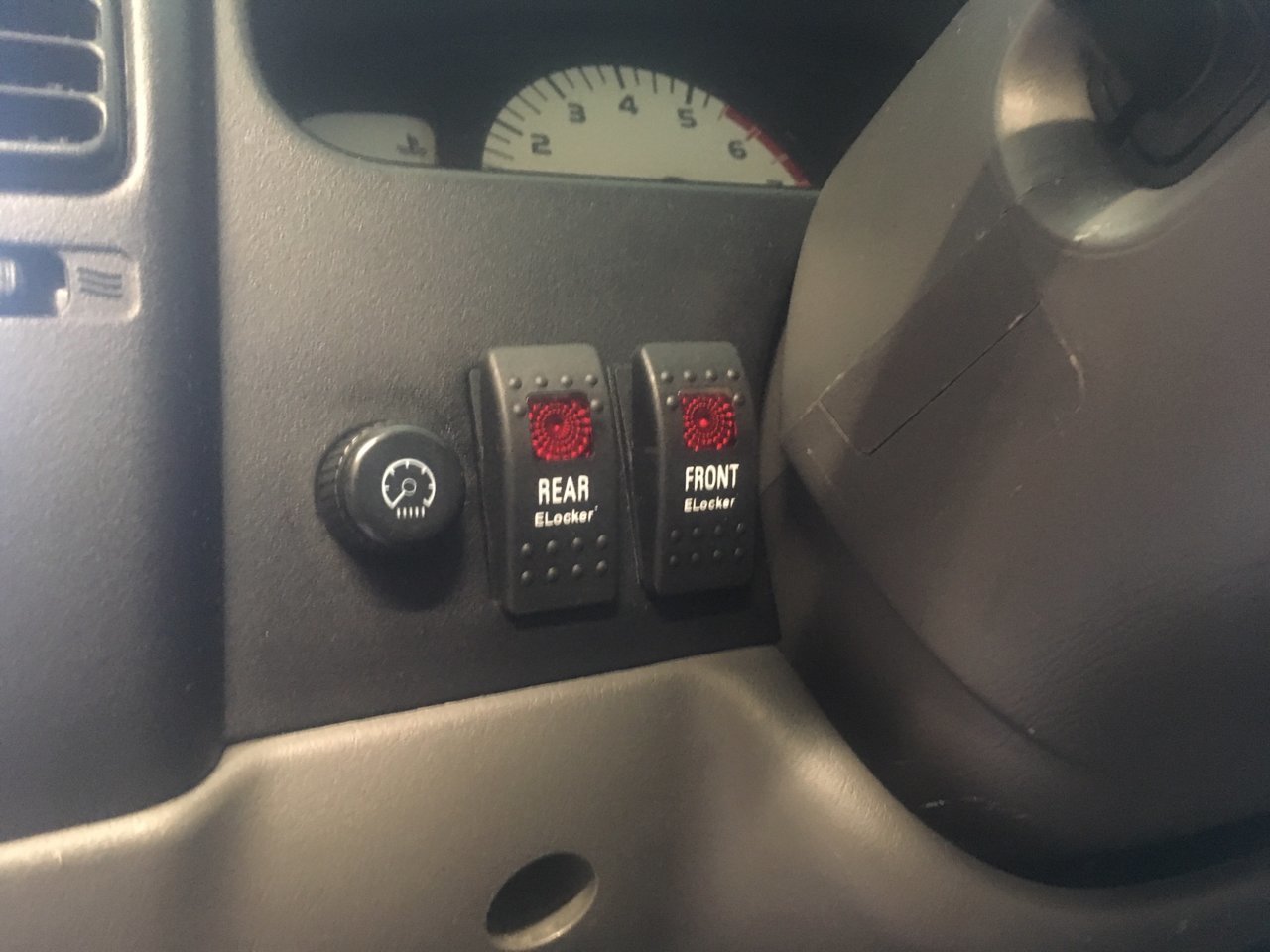

    @Kwikvette, it should come with the correct rocker switch, mine did. My truck’s a non-TRD regular cab so it had a switch blank where you’d find the rear locker switch on a TRD truck. For my rear locker I just removed the switch blank and used that location. I made a template of the opening and cut another hole next to it for the front locker.
    I do not give a goddamn about having dash lights for the lockers when the Harrops already include clearly labeled, brightly illuminated switches. Using the supplied rocker switches instead of an FZJ80 dial also allows you to operate the front and rear lockers independently.

    That's a clean setup.
    See the 4R I'm getting (or even the Tacoma I have currently) both have a factory rear locker.
    I wanted the front switch to look as factory as possible since I don't want to use the switch Harrop includes.
    That 80 series dial though looks badass; wonder if there's a wiring diagram available to hook it up to the factory rear and aftermarket front...

    Yeah there is a way to run that Toyota 80 series rotary switch. A lot of the Cruiser guys use those when they add lockers to their 100 series.

    That's what my first post was about; using an OEM rear locker switch for the front lol maybe I didn't phrase it correctly
