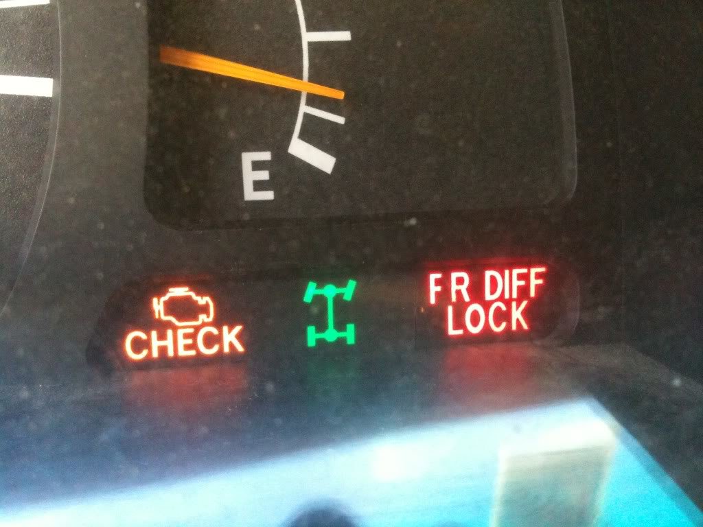

    It would be really cool if you could add a "FR Diff Lock" light in the OEM dash gauge too!

    As my partners, wife and friends will attest, I am just not that cool!

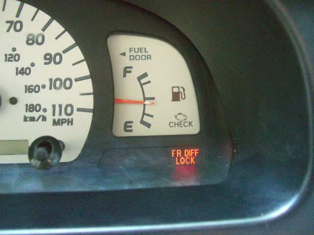

    I want my diff light to come on :(

    The light not on isn't enough of an excuse for me to go into the cluster haha. Although I'd like to change the cluster LEDs someday
