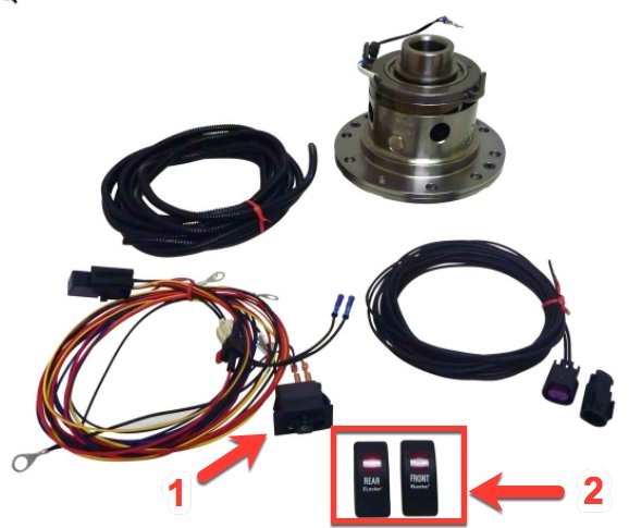

    A wiring diagram is included with the Harrop install instructions. I believe the lockers come with a relay and wiring harness included. From there, you just need to swap in the "ottrattw" switches instead of the Harrop-supplied 80 series switch?
    I'm sure Ward can jump in here if I'm missing something re wiring.

    Well........ one small correction. :)
    The OEM 80 Series two-locker rotary switch is something we sell as an option. Harrop does not provide. Their kit DOES include a Carling-style rocker switch like the one mentioned above (think ARB and every other generic aftermarket switch) along with two covers - one for "front" and one for "rear" so you can label the switch correctly. Switch is #1 below and covers #2 below. The switch has an indicator lamp that glows when locker is engaged.
