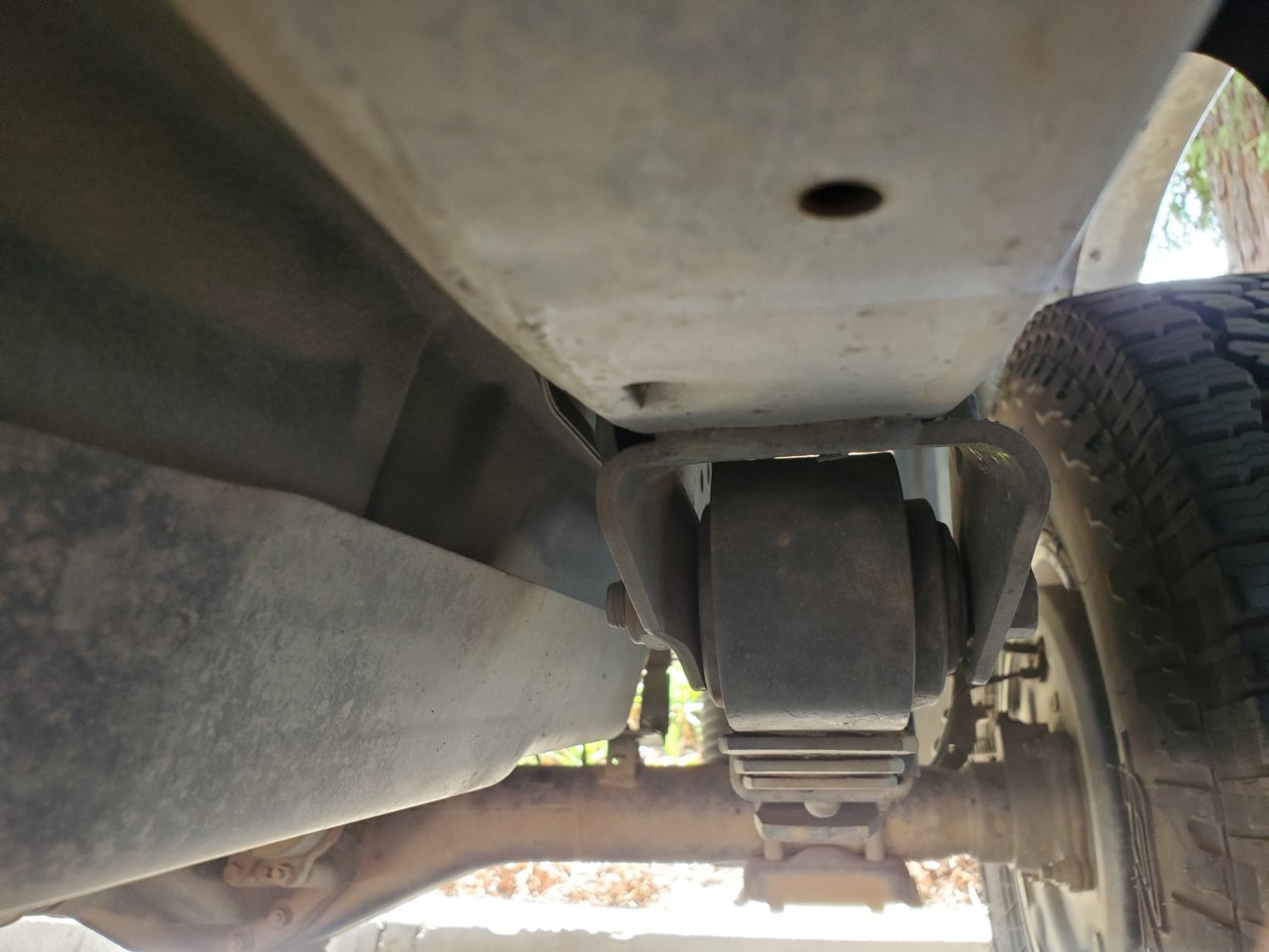

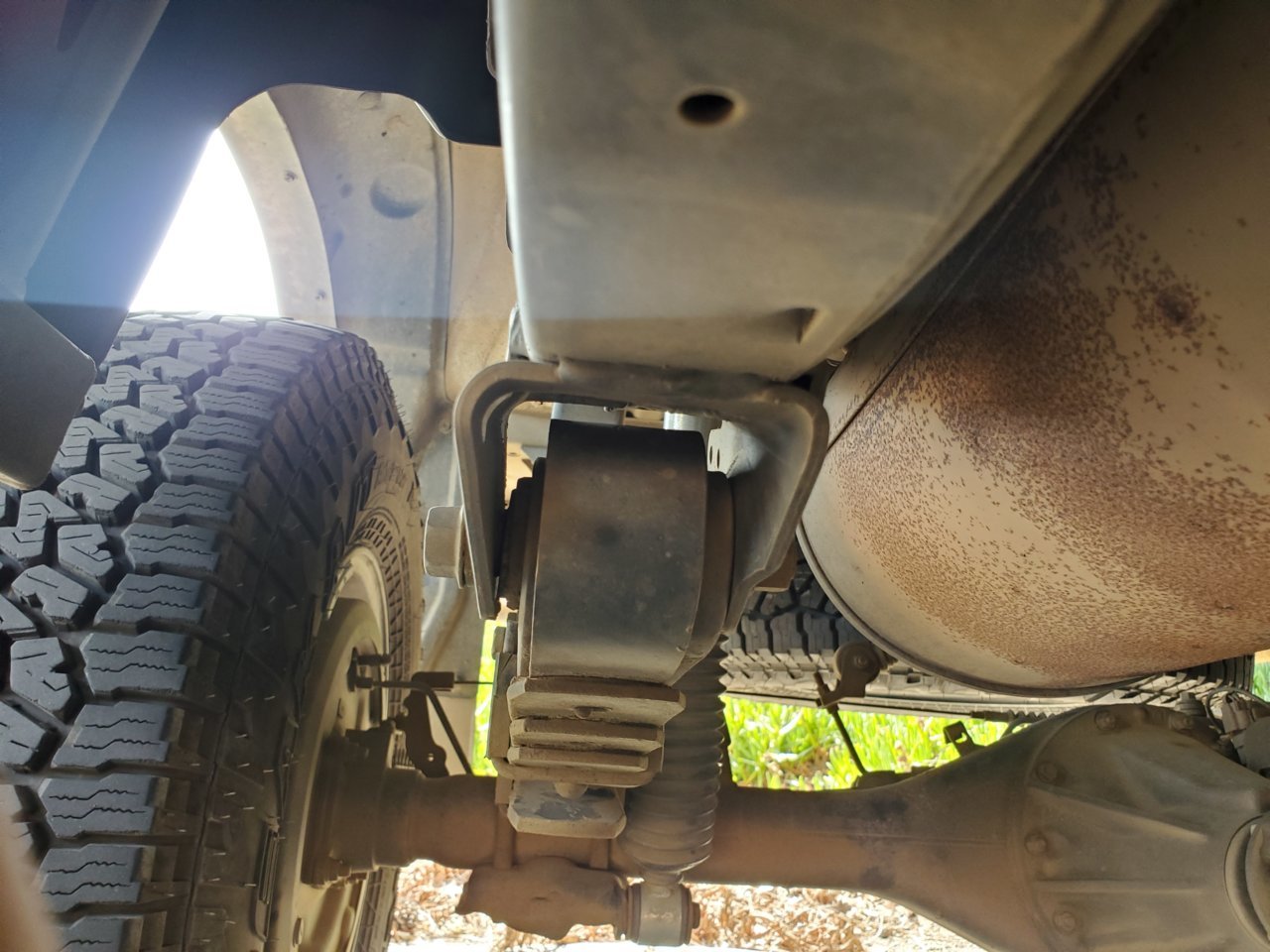

    So it's been about a 2 months-ish since my ome dakar leafs were installed and I just noticed today that the bolts at the front of the leafs are tightened differently on each side. Is one too tight or too loose?IMG_20200916_131121.jpg IMG_20200916_131053.jpg

    You forget the washers?
    Maybe you accidently switched bolts when you undid everything?

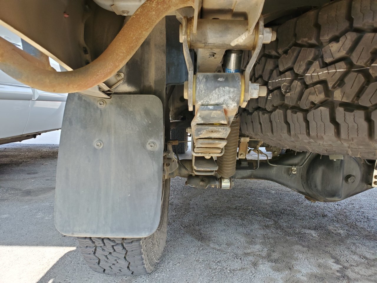

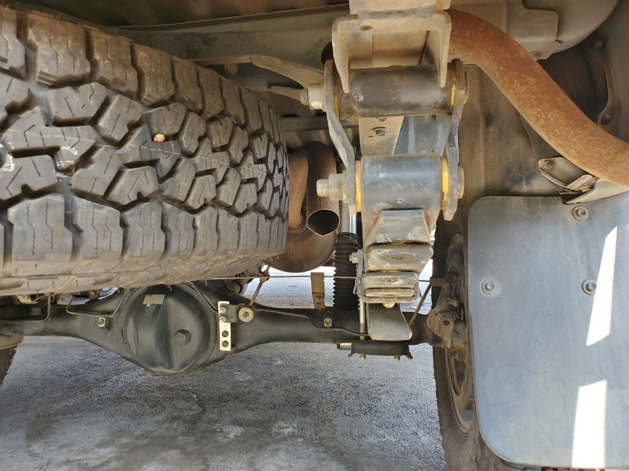

    I installed mine last year, here's how they look now

    Thanks! But I'm actually asking about the bolt on the other side.

    Just took pics but I just remembered that I had lost a nut on a trail (and washer) so I replaced it with one from Ace.
    Doubt they're the same width

    It might be the pictures but those eyes look different sizes going by the hanger

    You think that I should tighten the nut on the first picture? Because I mean both of ours look kinda similar. I just don't want to lose a nut while driving. (Lol the wording:D)

    Don't go by how much thread is exposed. Go by torque.
    Unfortunately you can't get a torque wrench on those nuts, and least on the driver side... I think my torque spec on those front bolts is "right before the vein in my forehead pops out" with a box wrench.
    Also, what is that crap dripping off them? Lube? You should use grease, not a spray lube...

    Both were torqued to the same spec but idk why they turned out like that. The spray lube is fluid film. I just put it on there to see if it can reduce the amount of squeak from the leafs, which it did.

    fluid film is NOT a lubricant. Grease the bushings with... grease... and the squeak will go away, too.
    I notice you have a washer on the bolt side of that 2nd pic. Pretty sure that washer goes on the nut side. The flange bolt shouldn't need one. That's how mine was/is anyway...
