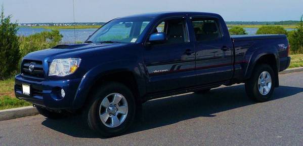

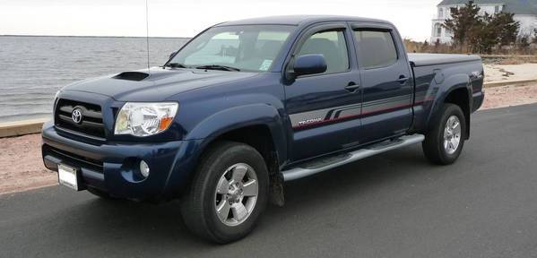

    Below I have a "before and after", since installing the Dodge plate bracket.
    You can see where the plate messed up the paint on the bumper. I was going to put painted plugs in the holes, but since there was some damage, I decided to experiment. I flattened out the holes and filled them with paintable, flexible, window caulk, then used touch-up paint. Its holding up pretty well and looks decent... considering.

    How does the dodge bracket attach? Self tapping screws into the bumper? Thanks :)

    It came with exterior, sheet metal screws. There are 4 holes under where the plate fastens that are used to secure it to the truck. The contour of the bracket is quite close to our bumpers, so it sits pretty flush. I used a dremel and a file to file tune the fit and pre-drilled the holes.

    So do the screws go into the metal bumper, or just the plastic cover? Did you get just the bracket, or the whole mounting kit? Thanks!
