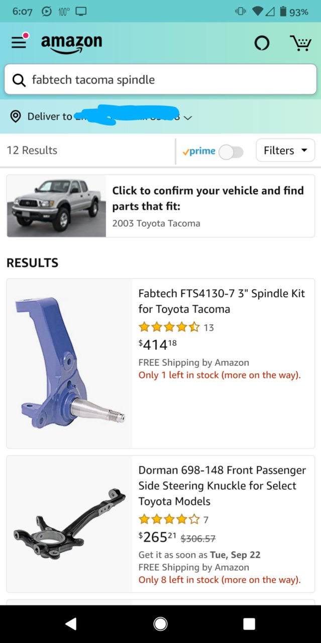

    Amazon.
    Fabtech spindles on there. Can also use v6 coils in the front for another inch lift if u havent yet
    Moog 81070 is part number
