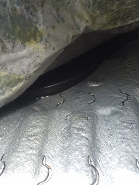

    5. There was a small amount of water beading up around the plastic structure that leads to the vent that cools the rear passengers. So I'm wondering if something could have backed up in the AC unit and caused water to slowly pool inside that. There is no evidence of water coming out of the vent under the seat, however.

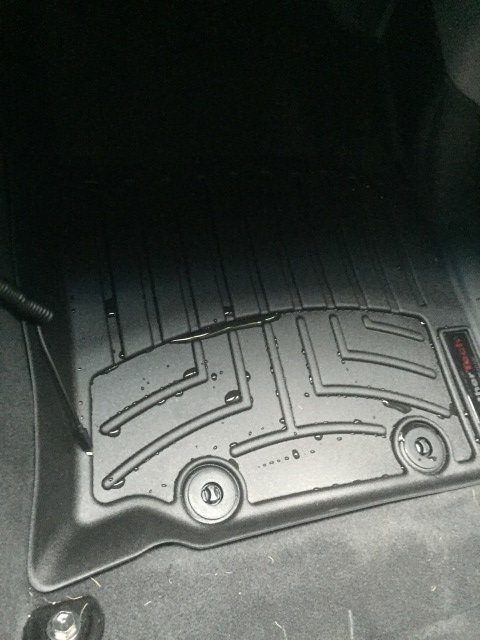

    See the attached photo. The whole carpet is pretty soaked underneath the floor mat. There is no moisture on the upward slope towards the firewall at any point. Does that give yall any clues? I hope the carpet is salvageable. Not looking forward to removing the whole interior to replace this carpet.:(

    What you're looking at is the duct that eventually goes under the front passenger seat to cool the rear pax. One from far away. The closer one shows water next to this duct

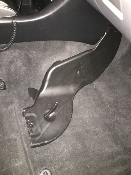

    Do you have a picture of the plastic vent tube? Is it fairly big or an actual tube?

    Here you go! I pulled the carpet back removed the section in the photo. It sits below the carpet as shown. After making sure this was the issue I also pulled the smelly wet padding off and trashed it. image.jpg

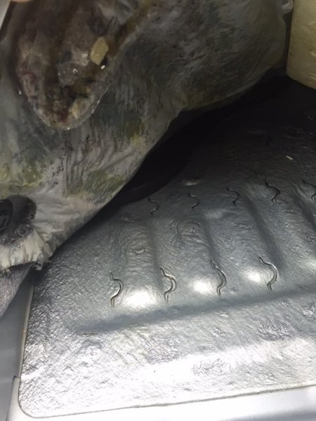

    Did you have to do anything for the water soaked factory sound deadening material (painted silver)?
