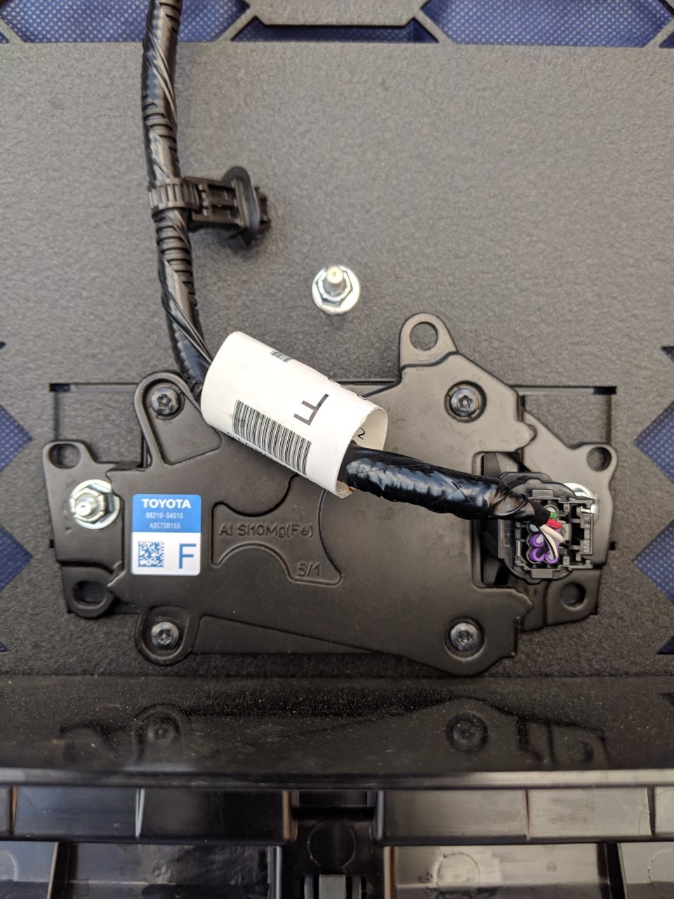

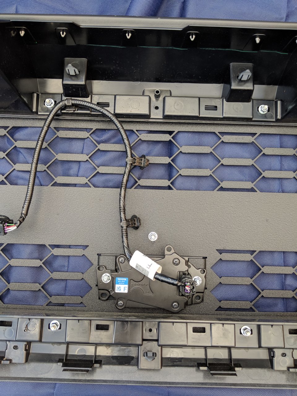

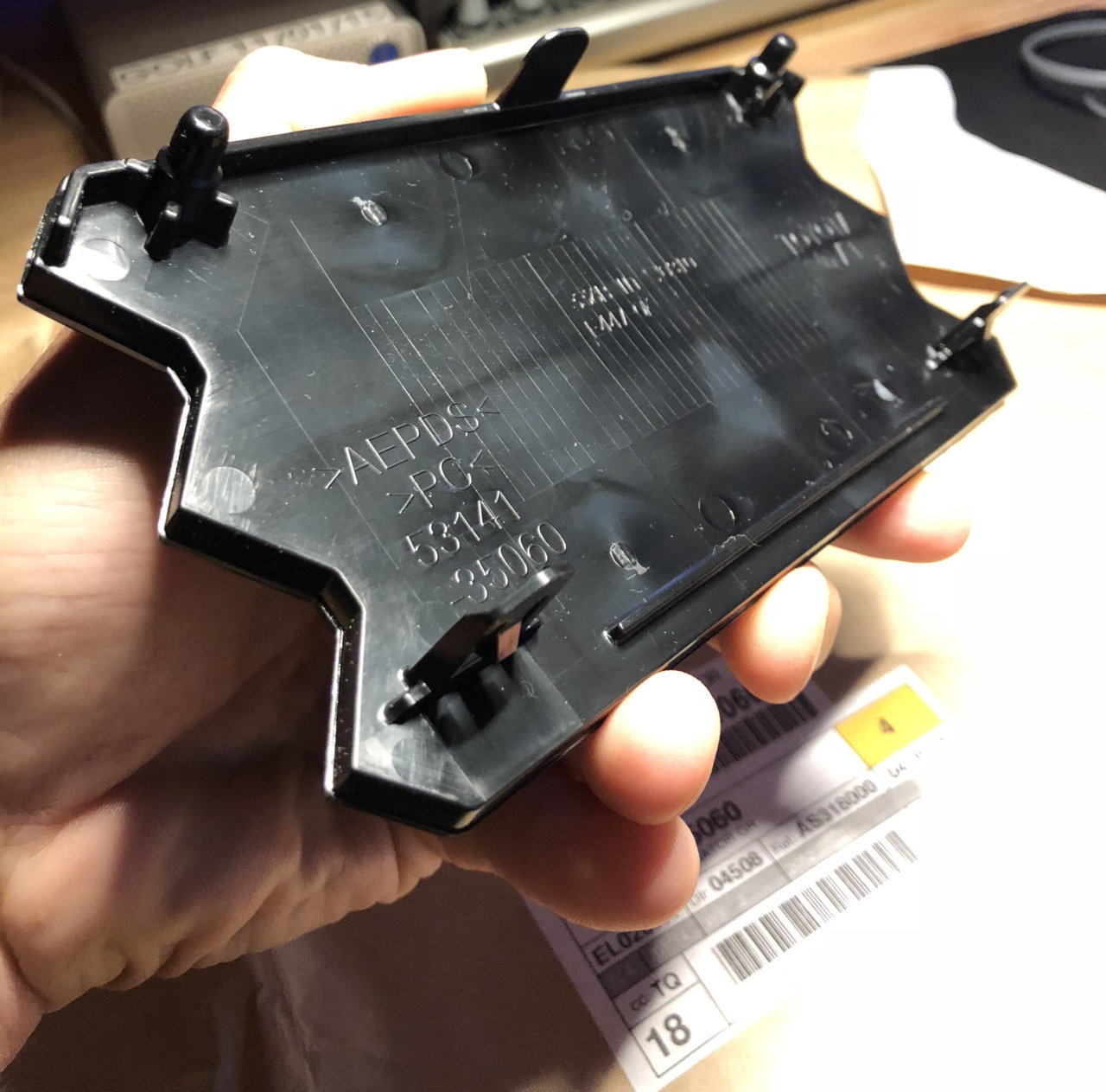

    I doubt the OEM garnish will fit that BPF metal grille. The mounting tabs & posts are probably different. Do you have a pic of the backside to see how it mounts?

    firemedic1343

    Damn good pics man but yea the OEM or a faux garnish won't work unfortunately. Here's what the backside looks like which is different from yours
