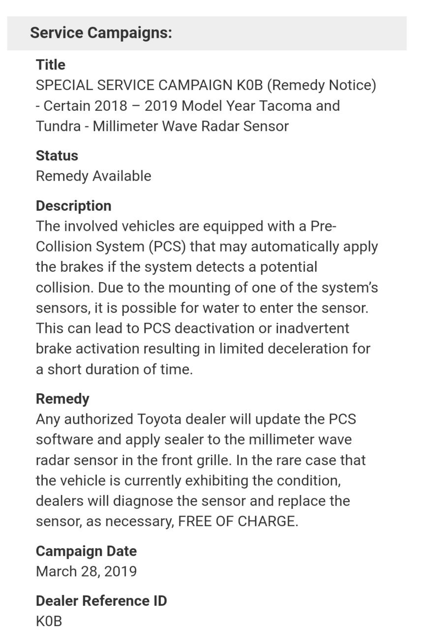

    As requested:

    Thanks for posting this, I have a 2018, and the sensor was replaced about 10 months ago. It is acting up again, I will bring this back up when it goes in for a brake recall.

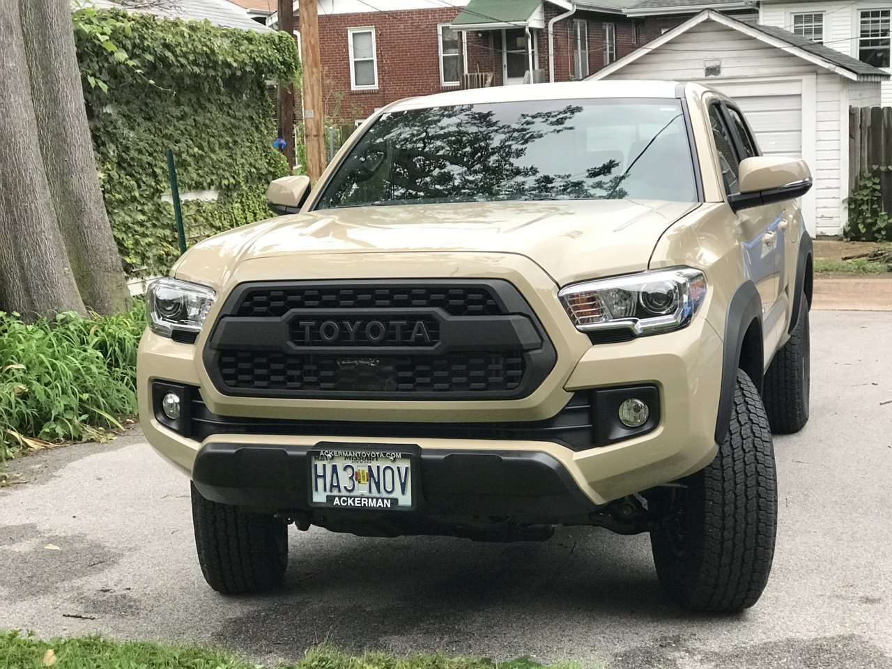

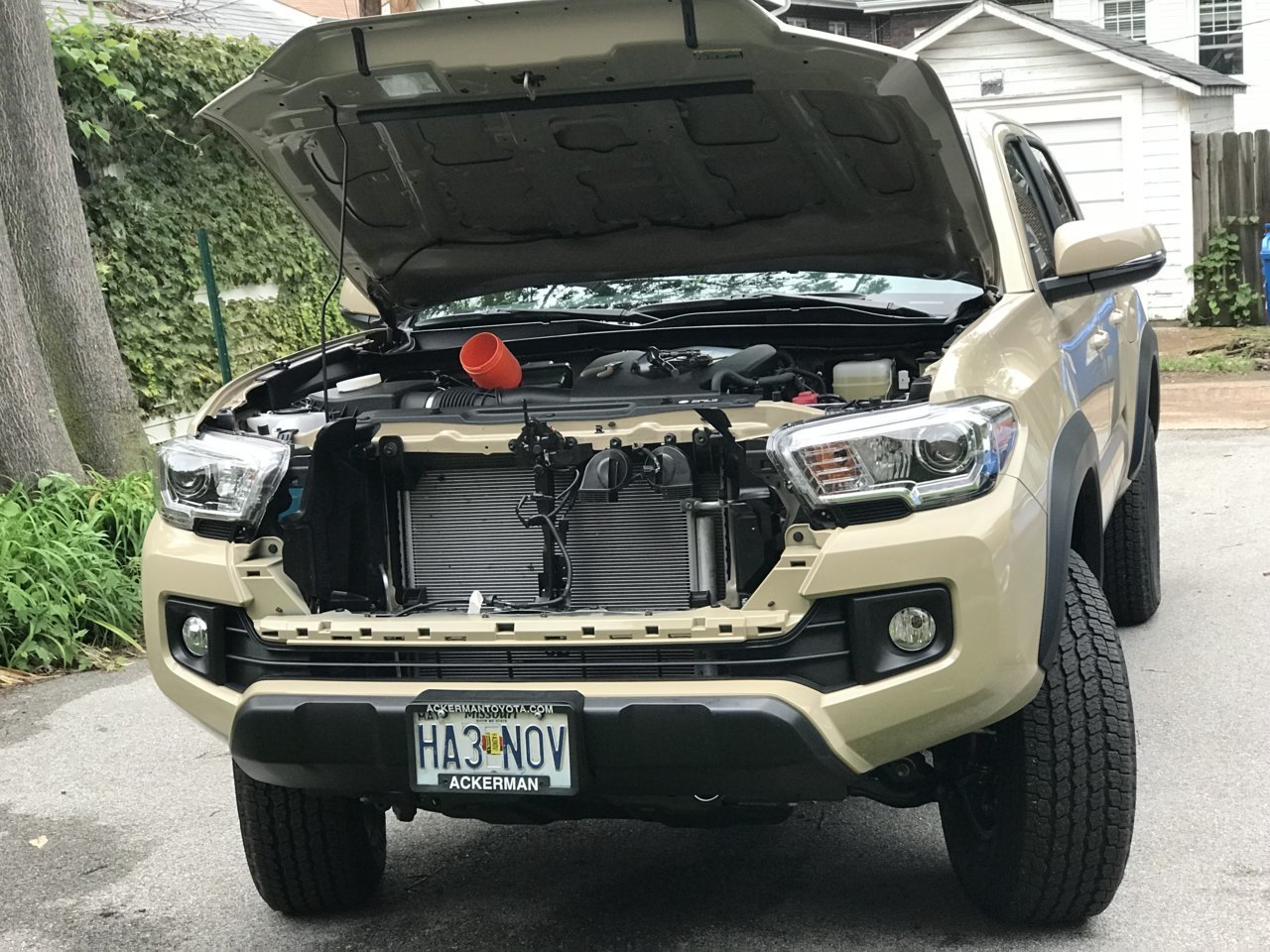

    Here is a couple of photos. My Tacoma was built in August 2018, the only thing that holds the cowl on is the 2 plastic fasteners on top and 10 or so plastic tabs on the bottom. Earlier models had a couple of 12mm bolts.IMG_1099.jpg IMG_1100.jpg

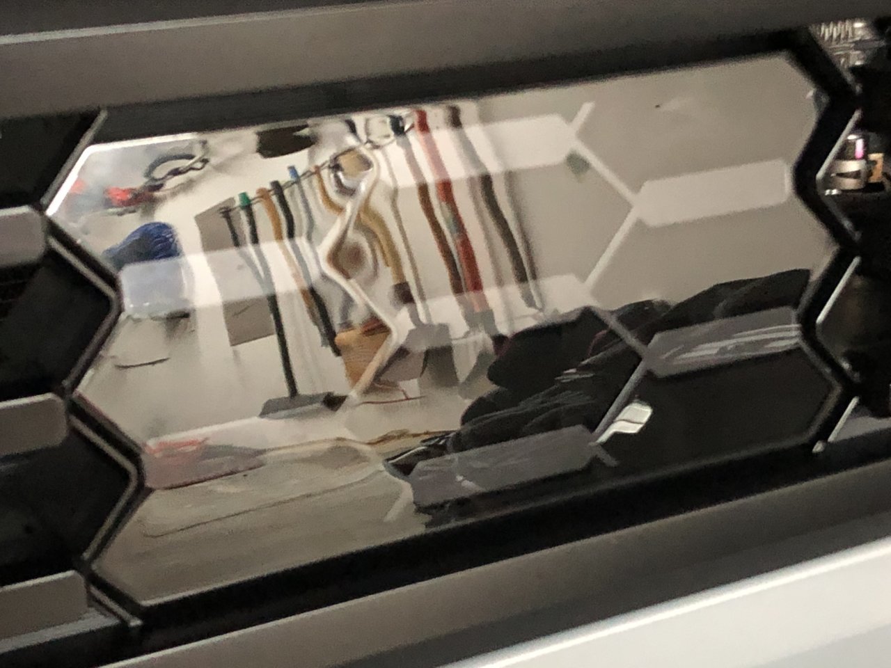

    I have what looks to be the same grille although i bought off ebay. I also bought what is supposed to be OEM garnish with the toyota pn and all on the back (however i've read this could be a fake also). I ran into the same problem with the gap being between the garnish and the grill at the top. I installed the clips on the nubs but still the garnish doesn't sit flat. Looking at the front it looks to be flush with the front of grille. I've only drove about 100 miles since the install but I'm getting the error on and off while driving. I feel if i pulling the clips off the nubs and glued flush with the grille it would actually stick out a bit in the front. Is this what yours looks like?

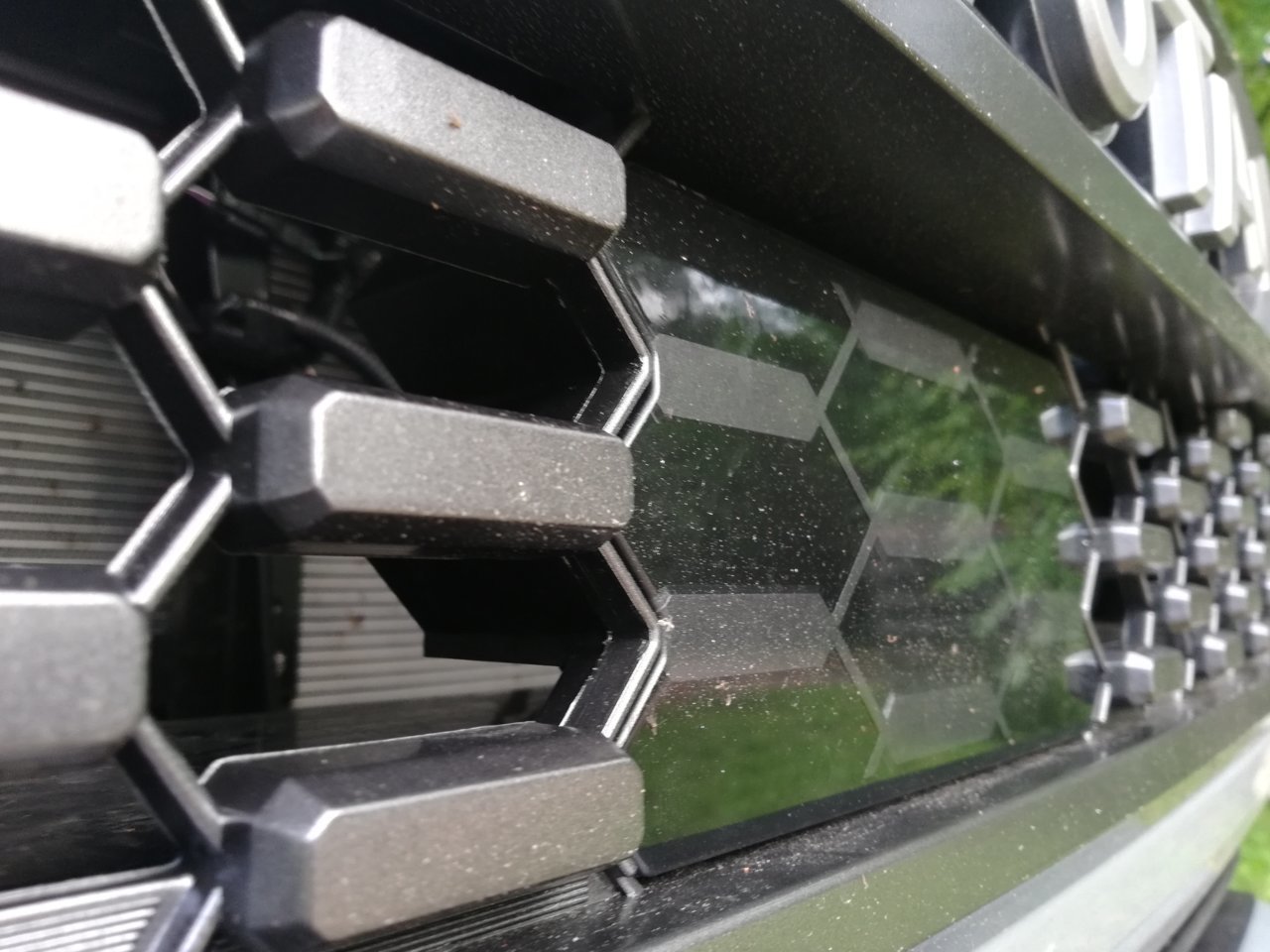

    this a pic of the front that hopefully shows the installed angle

    maybe someone here with stock pro can compare or someone with no issues after the install

    The garnish usually is flush at the bottom but recessed at the top for some reason. I've seen posts of using rubber o-rings to make it more flush on top. Not sure if this is creating your error or not. Also heard of an issue of leaving greasy fingerprints on the front of the sensor can cause errors also.
