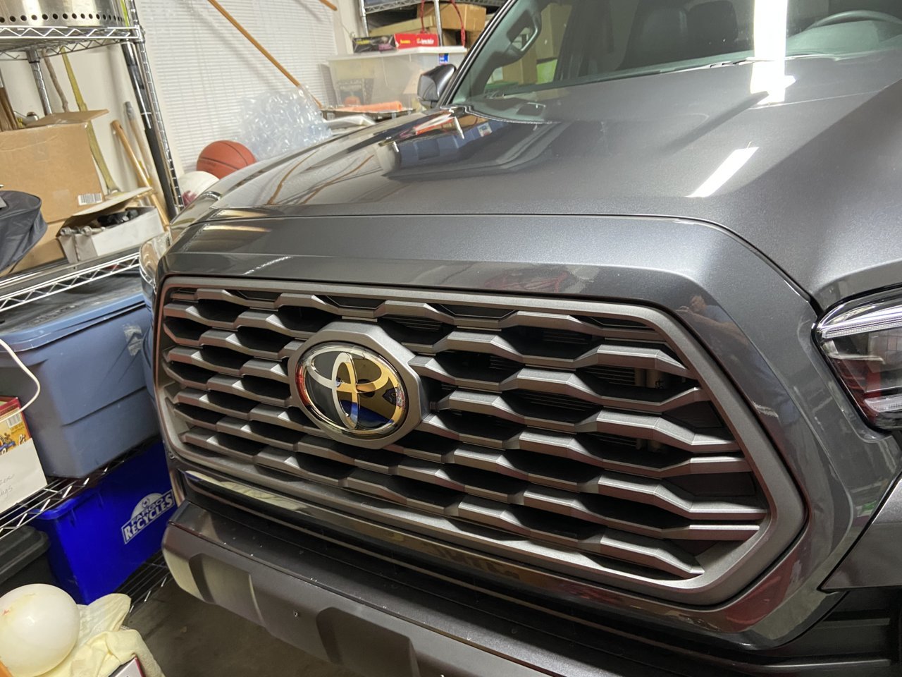

  18. Mar 19, 2021 at 7:48 PM
    #118
    D Soulman
    D Soulman Well-Known Member
    Feb 12, 2018
    #244260
    181
    Dan
    Fargo, North Dakota
    Well I already have the grill and like it waaay better than my stick grill so I really want to get this figured out. Stock grill pick for sympathy... 81B04FCE-A3B0-4EDB-8323-C60644FBED2E.jpg
