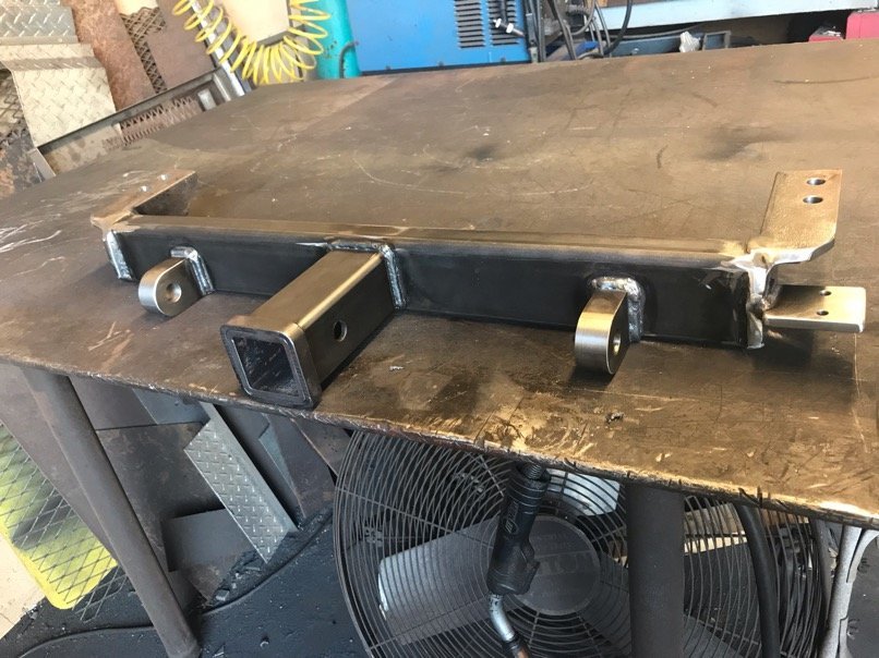

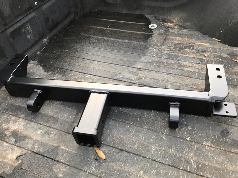

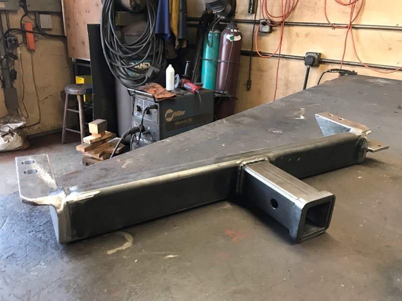

    Build you one. I built this one recently and had it powdercoated.

    I didn't know I needed one of these till I saw this, nice welds there!

    gawddamn you have some pretty welds, nice work sir

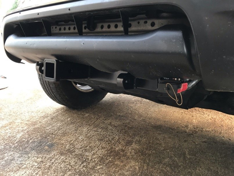

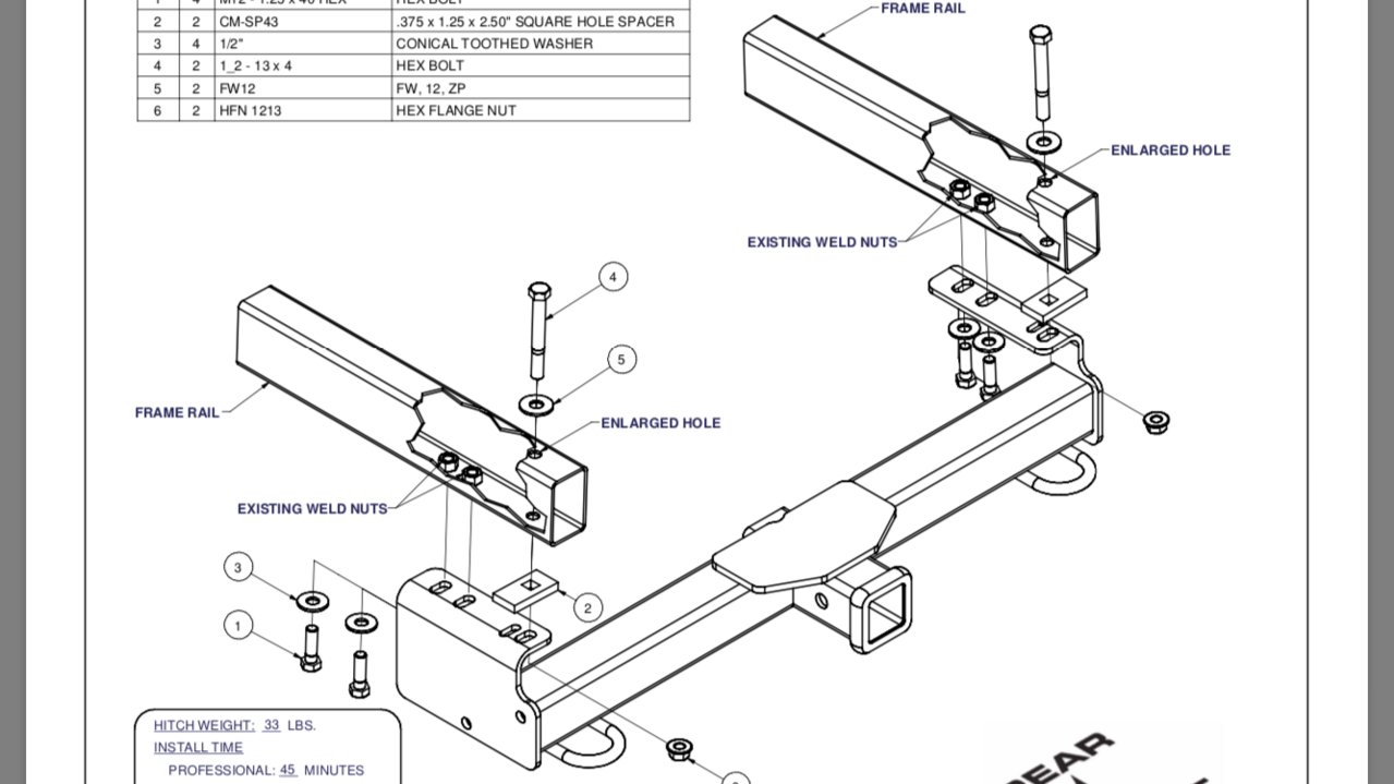

    You have to drill for the 2 points marked “enlarged hole”. Those holes were not there on my 2001 original frame so it added a bit of extra measuring. The hitch can be installed without removing the bumper though which was nice.

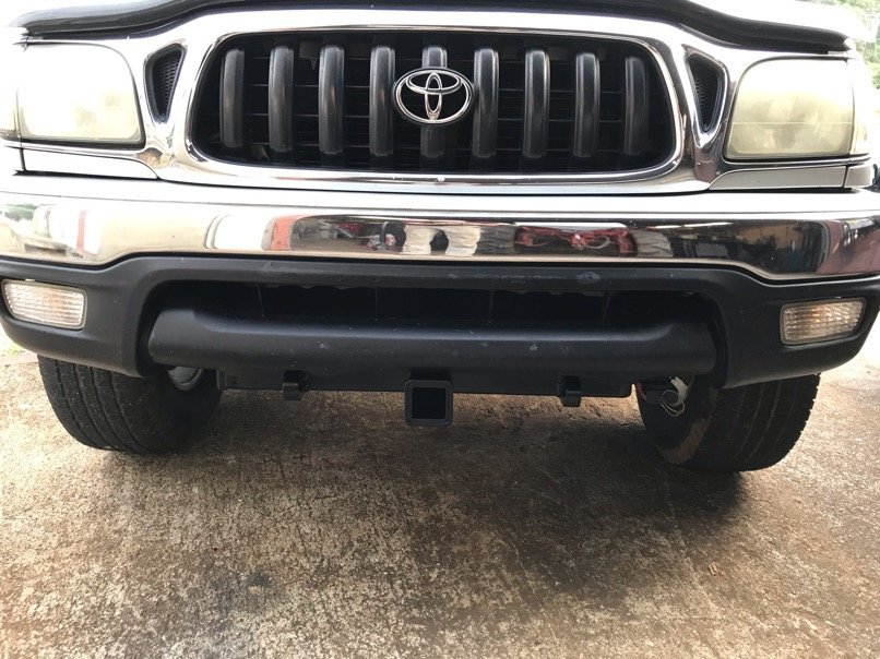

    I didn’t have to do any drilling on the truck. I just used the 2 holes on each side where the tie downs were.
