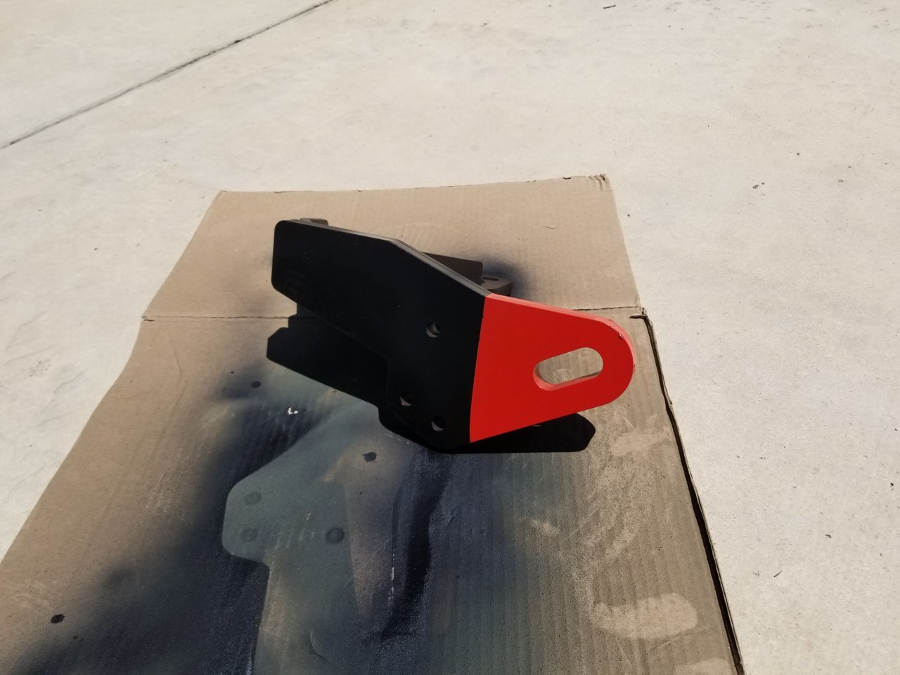

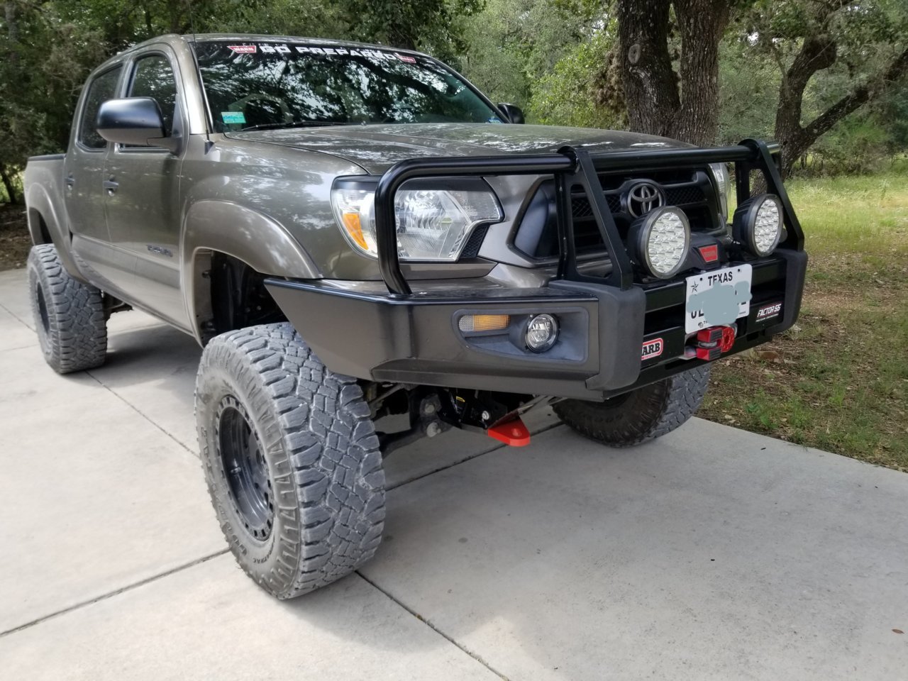

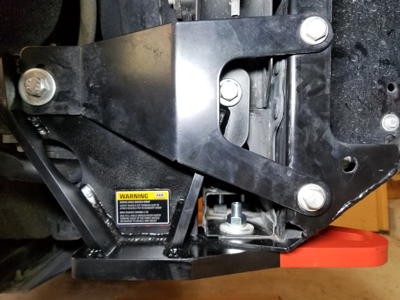

    I finally pulled the trigger on an ARB. I get it when people balk at the price. But, with my taco pulling a scout trailer often 1000's of miles away from home, with just me and the wife, I need to make sure I dont have recovery point failure to make things worse. I wasn't a fan of the all red, so I painted mine up. Also, just to see, I tried reinstalling the Y bracket back over top, and it fit fine. Everything flushed up and tightened up, so I went ahead and put it back on. May as well I figured. 20210616_123614.jpg 20210621_145814.jpg 20210622_230905.jpg

    Nice! What is the intended purpose of the Y-bracket?
  17. Jul 24, 2021 at 6:54 AM
    #37
    TxFireman
    TxFireman Factory Pilot
    Sep 7, 2013
    #112051
    1,158
    San Antonio, Texas
    2013 DC-SB TRD-OR, tow package, entune/nav
    The Y bracket is part of the original ARB mounting hardware. Directions for the recovery point show it being removed and left off. But I found in my case it would mount just as it had before, without effecting anything, so I simply just pit it back in with the recovery point in place. I figured if it fits and doesn't obstruct anything, then why not go ahead and have the extra support.

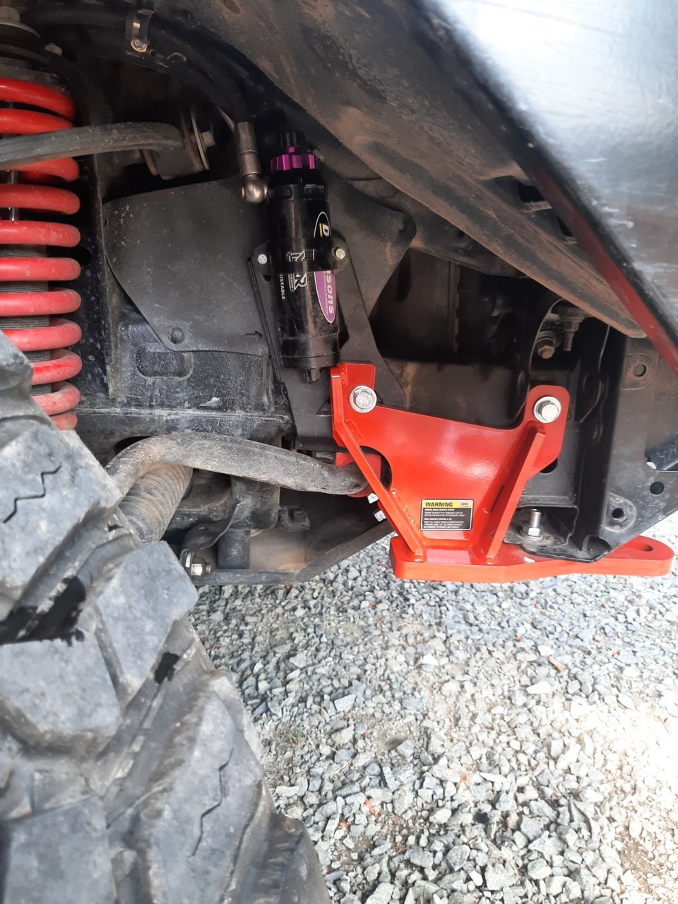

    Installed my arb about ao the ago
