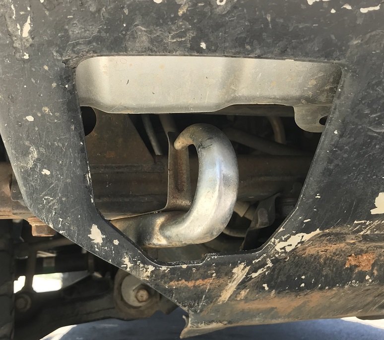

    I bolted a Smittybilt 7505 chrome hook on the passenger side, in place of the OEM transport bracket ($18 now; $11 when I bought it on Amazon in 2012). I originally installed a Curt 22430 hook, but the paint chipped off and replaced it with the Smitty. It does sit at an angle, but its shouldn't affect it intended purpose.

    Interesting skid plate. Looks like it could be TRD aluminum one painted black. They seem hard to find used.
    Unless it's a different kind.
    Yes I've seen those hooks cheap.
    I can't seem to find any suggesting fitment for the 2nd gen Taco so maybe they're universal.
    How'd you bolt it on? Did the holes line up and you just re-used factory hardware from the tie-down?

    Yep. I used an identical hook off my dad's 1997 Toyota pickup on my truck. Bolt holes have been standard for years on tow hooks it seems

    I'll double-check this weekend, but yes, I believe the bolts lined up and I used the OEM bolts. Yes, on the TRD alum skid plate painted black - needs a new coat.
