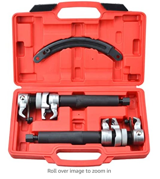

    A while back I got a recommendation from this forum for a spring compressor another member had luck with. I bought one since I knew I was going to have to remove some springs down the road and that if it even worked once it was worth the $$. This, specifically, was for an extra set of coilovers I had, so doing it on the truck wasn't an option (nor preferred IMO anyway).
    I bought a cheap version from Amazon but there are name brand ones available too.
    https://smile.amazon.com/gp/product/B08PQLRP8W?ie=UTF8
    I used this on some 650lb TRD Baja springs and it worked quite well. I was able to disassemble and re-assemble two sets of coilovers without issue. IMO, well worth the $45. If I had more regular use plans I'd probably fork over more for a nicer version though.
