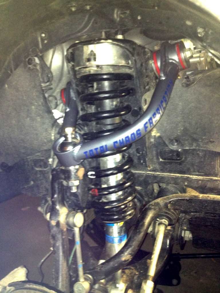

    They break because with any added top plate spacer lift, at full compression, your bump stop is still x-amount of inches/cm from hitting, meaning the first thing to break is the stem of the shock where it connects to the LCA.
    I have my billies at 2.5" with stock UCA's and the angles are fine, so is alignment. I will be installing my All-Pro uniball UCA's soon, though, in preparation for the Icon coilovers I'm replacing the billies with.
    The only way a dealership's service dept. can deny you warranty service is if they can prove to you, on paper (not just telling you, but showing you) that the modification you made to the truck is the cause of whatever problem you're truck is in their shop for. Bilstein 5100's are a direct replacement shock for the Tacoma, so I seriously doubt it will ever cause you a warranty problem.

    i guess ill never understand the logic behind spending the money for TC uca's but running a spacer lift rather than buying OME coils or some 2.5 coilover.
