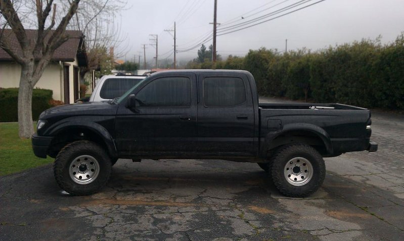

    Here are a few pics of my truck so you can see what I'm dealing with.

    It really doesn't ride that bad but I bet if I put good springs on it I would feel a big difference.

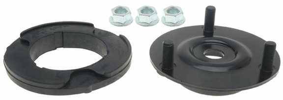

    After further review, I still have these parts under the spacer. I think I'll go with Eibach's if you say they were specifically tested with the 5100's.

    Wasnt really following the thread but noticed your pics.
    IS THAT A 5100 SHOCK WITH A SPACER TOO????? :eek:
    GEEZ!!!!!!!!!!!!

    Not knowing much about Tacoma's lifts or suspensions, I wouldn't know if this was good or bad. I bought it like this.

    If you set the 5100s on any other setting with the eibachs, you will see parts failures, either CVs or CV boots. And it will definately ride like crap and will shorten the life of the shock.
    Going beyond 3" of suspension lift with stock upper and lower control arms is asking for trouble.
