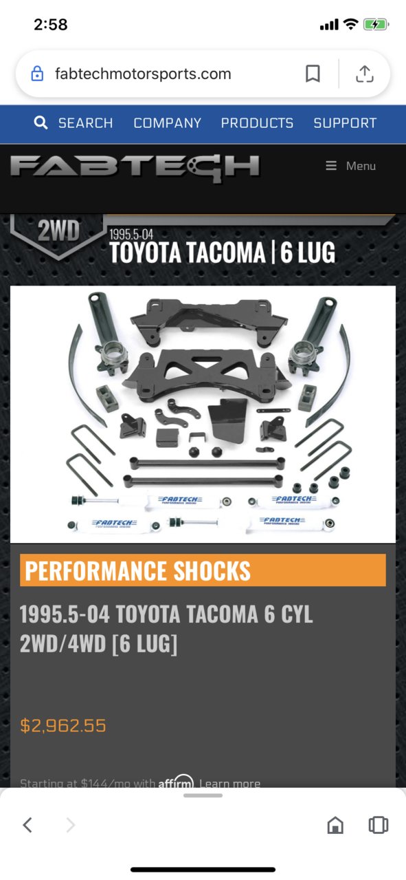

    Here’s the 95.5 - 04
    6” Fabtech lift kit.

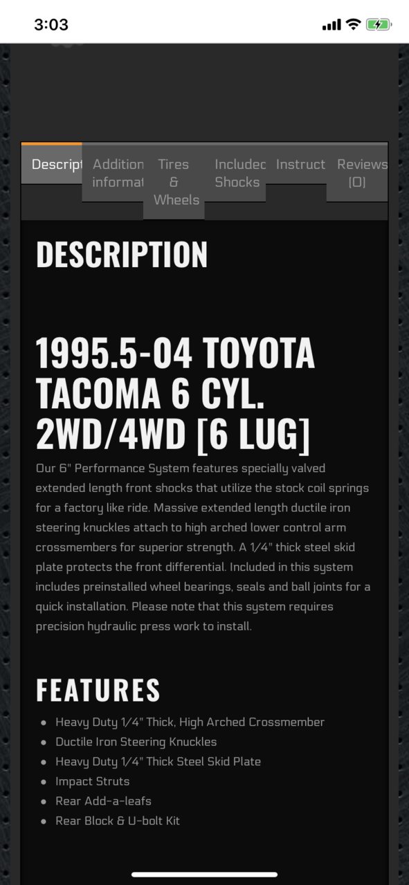

    You can see all the components there. Not sure about the front shocks/coilovers
    Looks kinda weird
    Edit - I see. Notes indicate it uses the stock coils

    hmmmm ya ive seen the fabtech parts, called them and they didnt really have anything for me. they said to get new springs somewhere elae and buy a new leaf kit, somewhere else... thinkin more about some adjustable shocks with a large spacer on the top and finding a shop to build me a new leaf pack...
