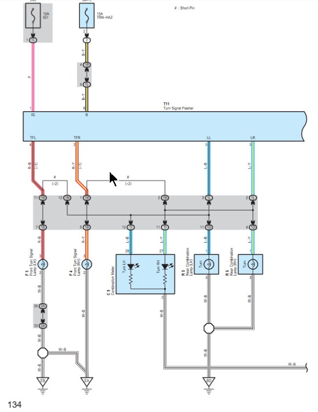

    My truck’s right blinker was blinking fast so naturally I check the right blinkers. It was the front right that was out. I replaced both front blinker bulbs and went to test them but my right blinker still isn’t working. But when I turn my blinkers on inside the cabin my right blinker flashes normally. It’s not blinking fast anymore but the light is still not working.
    faulty bulb? Need a new wiring harness?

    Do you have a multimeter or a test light to check for voltage at the bulb socket?
    If so check to see what you have at the light socket. Then we can make some educated guesses and suggestions.
    Is the rear right turn signal working?
    The voltage for both front and rear come from the same place.

    Swap the left front and right front turn signal bulbs, see if the inoperative front bulb switches from right to left. If the right side stays inoperative, then try swapping the bulb socket itself, from right to left side (they do unplug from the harness).
    If the fault follows the bulb socket, there's your problem (and they're fairly cheap from the dealer). If the right side is still inoperative, there's a wiring issue afoot and that diagram Jimmy posted will be helpful in diagnosing the circuits.

    Well if you cannot check for voltage how are we supposed to help you?
    Buy a meter or a test light. Both are cheap.
    If the rear lamp is working that rules out the flasher and wiring up to where they split between front and rear junction block.
    If the rear is working and the bulb is good and you are sure it is plugged in all the way. It is a wiring problem.
