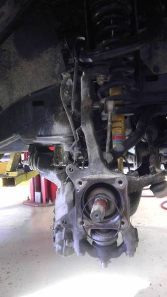

    So ive somehow managed to obliterate the front wheel bearings and essentially weld them to the hubs.. due to friction and heat. The dealership cant press them out so im getting all new hubs and bearings! i havent been wheeling in awhile and havent tweaked the truck bad at all i do have 94,000 miles on my tacoma though. thoughts on how i may have destroyed them?
    Working on pics if that helps any opinions would be apperciated as ive never broken this before..
    itll be on the lift until tuesday at the soonest...

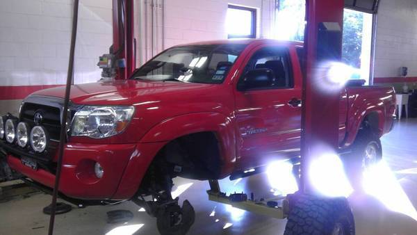

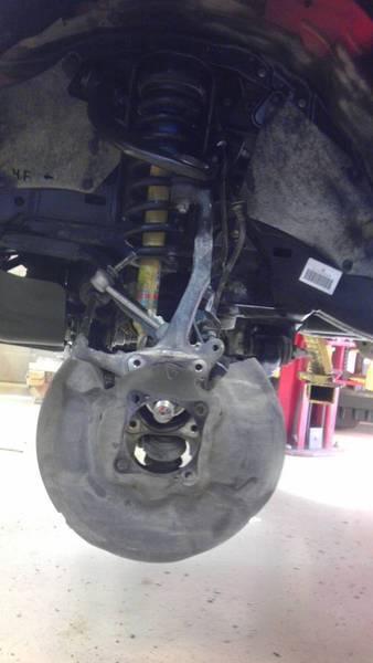

    im not too sure i am running spidertrax and 285/75/r16 KM2's right now. ive also added the best pics i could get sorry if they're not too good they were taken off an evo

    If they really wanted they could get them off. I've replaced 3 front bearings on friends trucks that were welded on from the heat. Just pry the old bearing apart, then cut the inner part most of the way and you can crack the brittle steel and slide it off.
