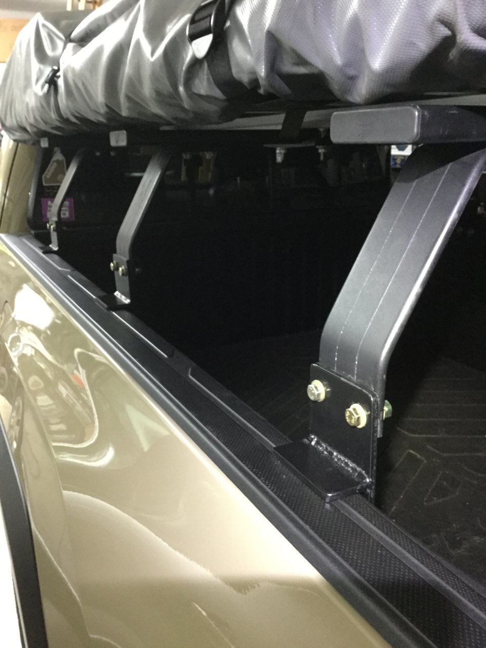

    I’ve got Frontrunner bars but I also had extended brackets made so that my RTT would sit at cab height.
  7. Feb 7, 2019 at 9:27 PM

    Man I dig those extra brackets...takes some of the load off the bed rails which was my primary issue with the front runner rack. No one at front runner would guarantee me that the rails could support the weight of a roof top tent plus body weight, and off road abuse. So I went with a different rack. Wish frontrunner offered brackets similar to the ones you have. If they did I’d have one right now along with tons of their rack accessories

    Just some I had made by a machine shop.

    Did you make those brackets yourself? Or did you buy them?
