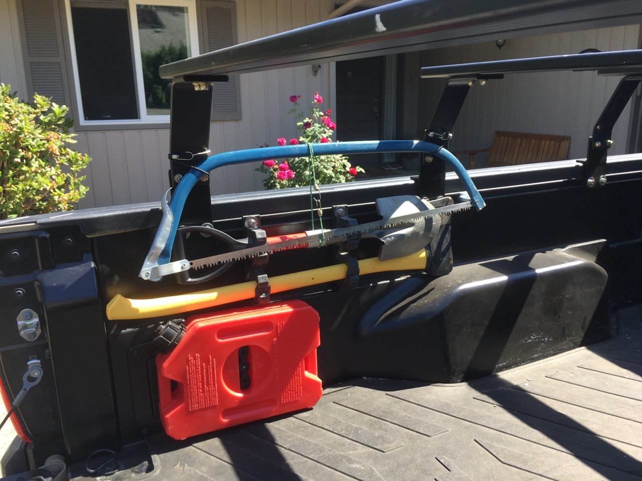

    I had them made by a local machine shop. Cost me $80.

    Still no issues. I pull the tent off after each use and I’ve used it 2-3 times since that post. I don’t do many hard frame flexing trails or rock crawling though.

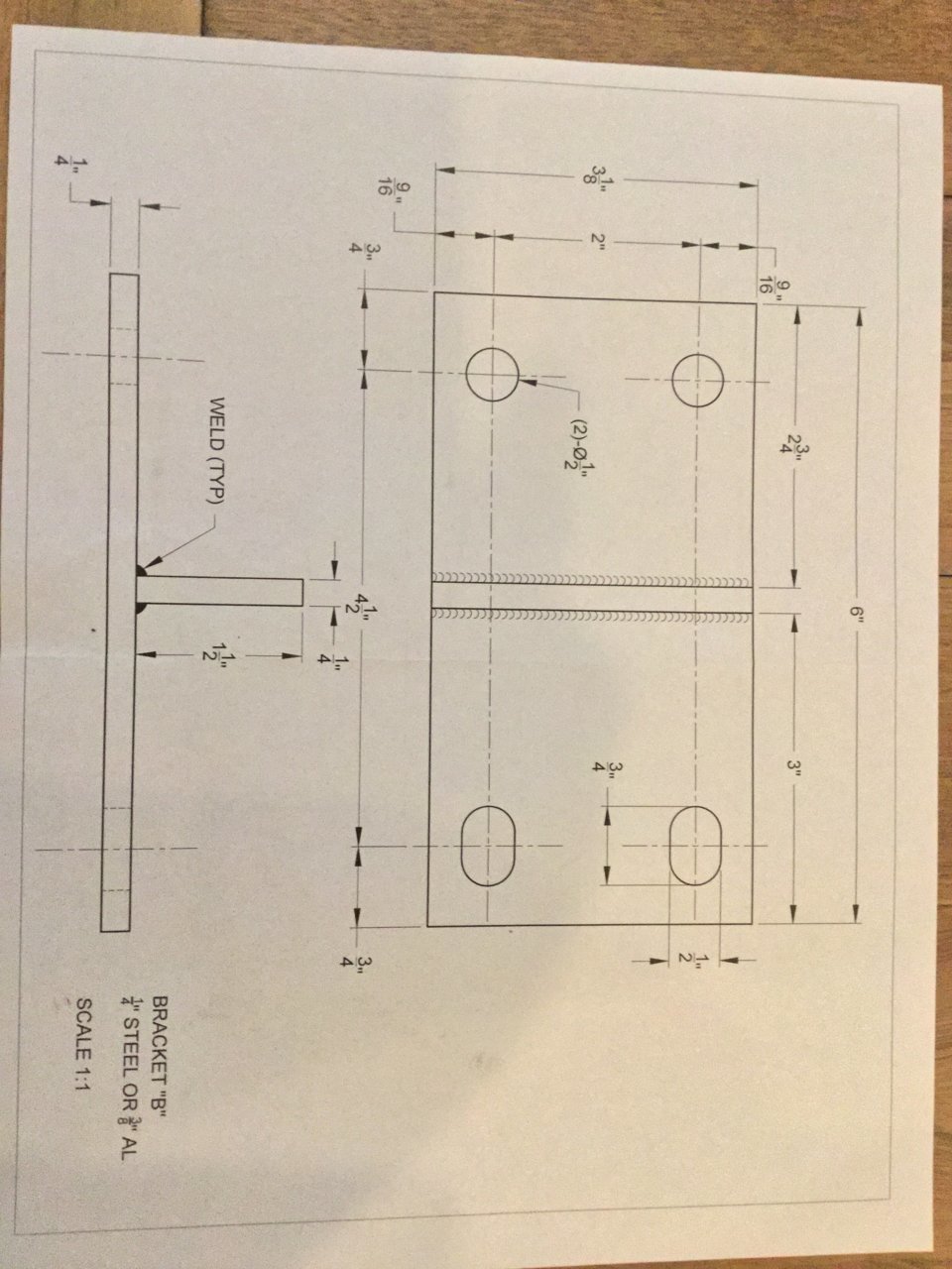

    They don't have a flange that sits on top of the cap like mine do, and as I run three bars the cost of those would be a lot more than what I paid because I didn't mention that I also got brackets for securing the RTT to the rails included in the $80 price. I'm in Kenya right now but I'll be back next week so I can post a drawing of the brackets that you could take to a machine shop to have made.

    Has anybody bought the full rack with an extra set of lets? @Captqc i am really interested in looking at those drawings. Did you get them power coated too?

    Heres the fab drawing. They bolt to the bed rails.

    Thank you! Any pics of the inside you have conveniently?

    As you can see in my pictures I run three bards with my RTT. It is very solid, I haven’t ran this setup on any hard off-road trails but lots of old logging “roads”. After three seasons I haven’t seen any signs of bed flex or cracking and I don’t have bed stiffeners.
