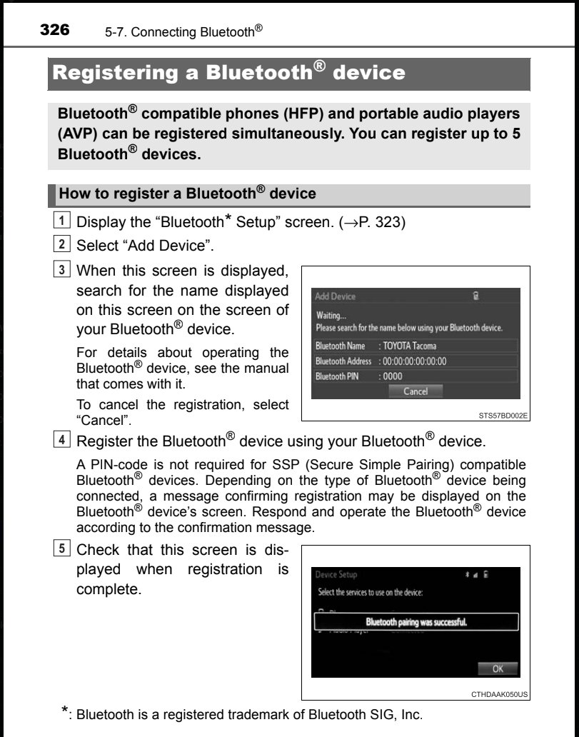

    Owner's manual-Page 326

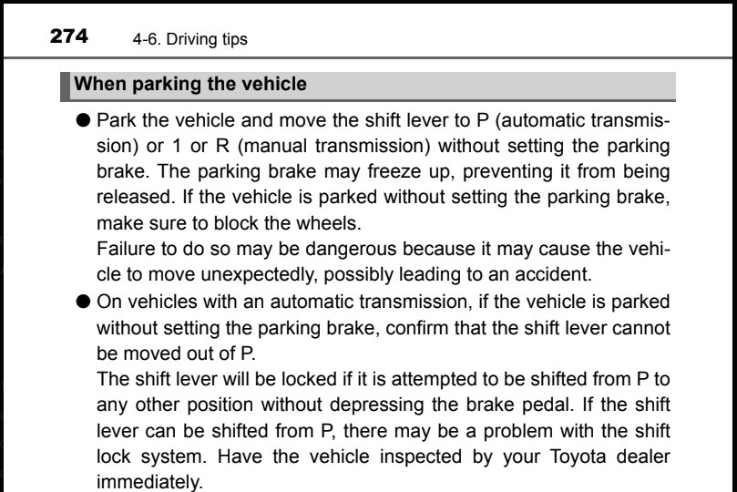

    I'm seeing Page 274:
    I'm not confident that folks would chock their wheels?

    Hmm. Must be a different page depending on the year. this is from the 2018 manual.
