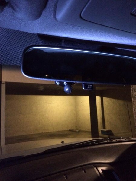

    Annnnnd, it showed up today.
    Wow, that was fast.
    Looks really impressive, looks really well made. Off to go install it.

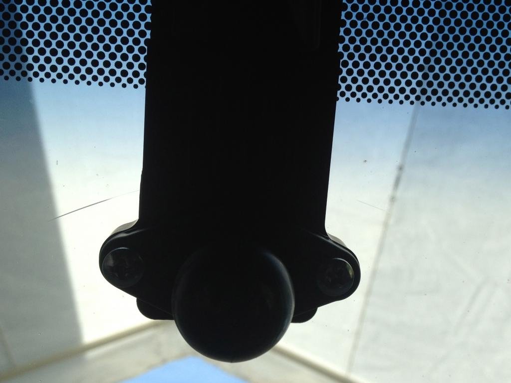

    So, I installed this thing last week, was really liking having the mirror up out of the way.
    Go out to my truck this morning and find this.
    Dammit!

    Not sure what we're seeing here. Did it pull loose?

    Looks like his windshield has a crack to the left of the mount

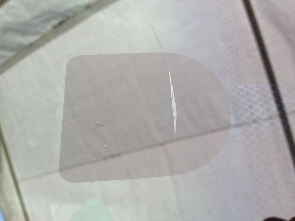

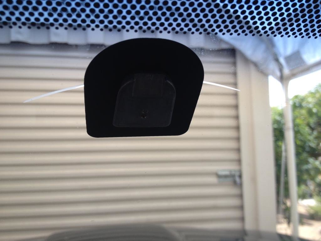

    About a 5 inch long crack centered under the riser. If you look carefully at the pics, it is on both sides of the mirror.
    I was concerned about the additional leverage placed on the glass mounted mirror by this thing, even asked about it. Didn't hear anything either way, figured he had sold enough of them without complaints so I pulled the trigger on it.
    Pretty sure I didn't install it incorrectly, I didn't go nuts tightening down the hardware, trimmed the OEM mirror bracket, made sure there was no contact or sharp edges pressing against the glass.
    Now it is a $900 mistake (about what an OEM replacement windshield costs). Plus having to either live without the trim plate that covers the wiring for the cam and auto dim or replace the OEM mirror as I had to cut off the bracket that holds the trim to mount this thing).
    Pretty bummed about the whole thing.
    ETA: Just pulled the riser off.

    That sucks. Did you have anything hanging off the RAM mount prior? I've had mine for several weeks now with no issues. I've only used the RAM mount once, on a recent road trip. It was holding my Spot beacon, which doesn't weigh much.

    The crack does look to be on the inside layer of glass. How is the factory mirror mount attached to the glass?
