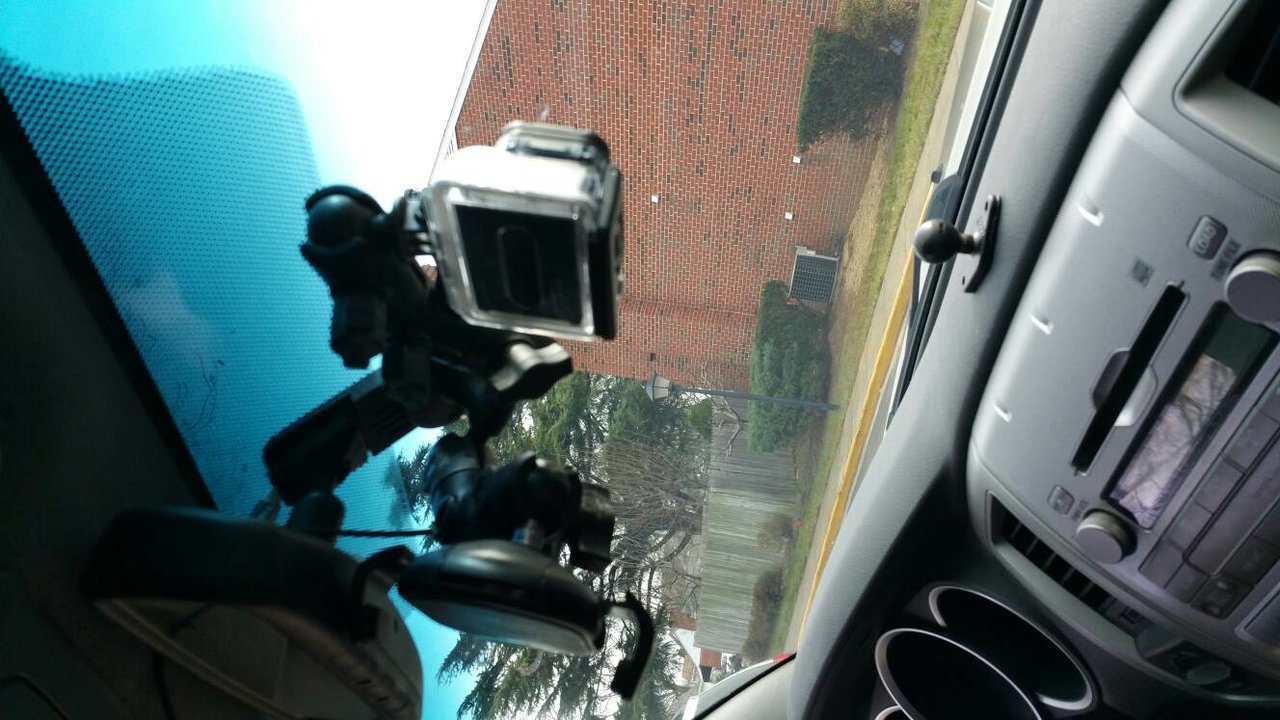

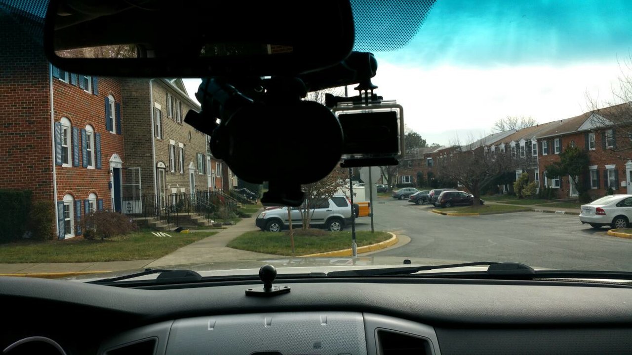

    I have my cellphone and go pro on a double ball.

    ok so how can i get mounts for the gear i want to hang that connects to the actual ball?

    Get them off ram mounts website, or Amazon like I did. Price point was better. Still a small fortune, but less than I found anywhere else.

    My cell phone holder is a modified Nokia wireless car charger holder. I removed the sticky suction cup base with a screwdriver. Then using a die I threaded it to quarter inch 20. I did that knowing that RAM already had a ball for sale on their website that would take those threads. After that it was simple. Run the wire and adjust the swivel of the articulating arm. After having this dual ball mount, I think I might just buy another one of the extended thread Ram balls. That would allow me to go back to a single ball on the riser. And the ball would take the place of one of the screws on the articulating arm.
