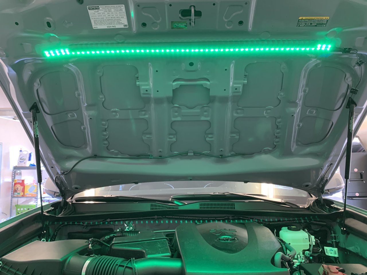

    Got the hood/bed kit and just finished up the hood. As promised.

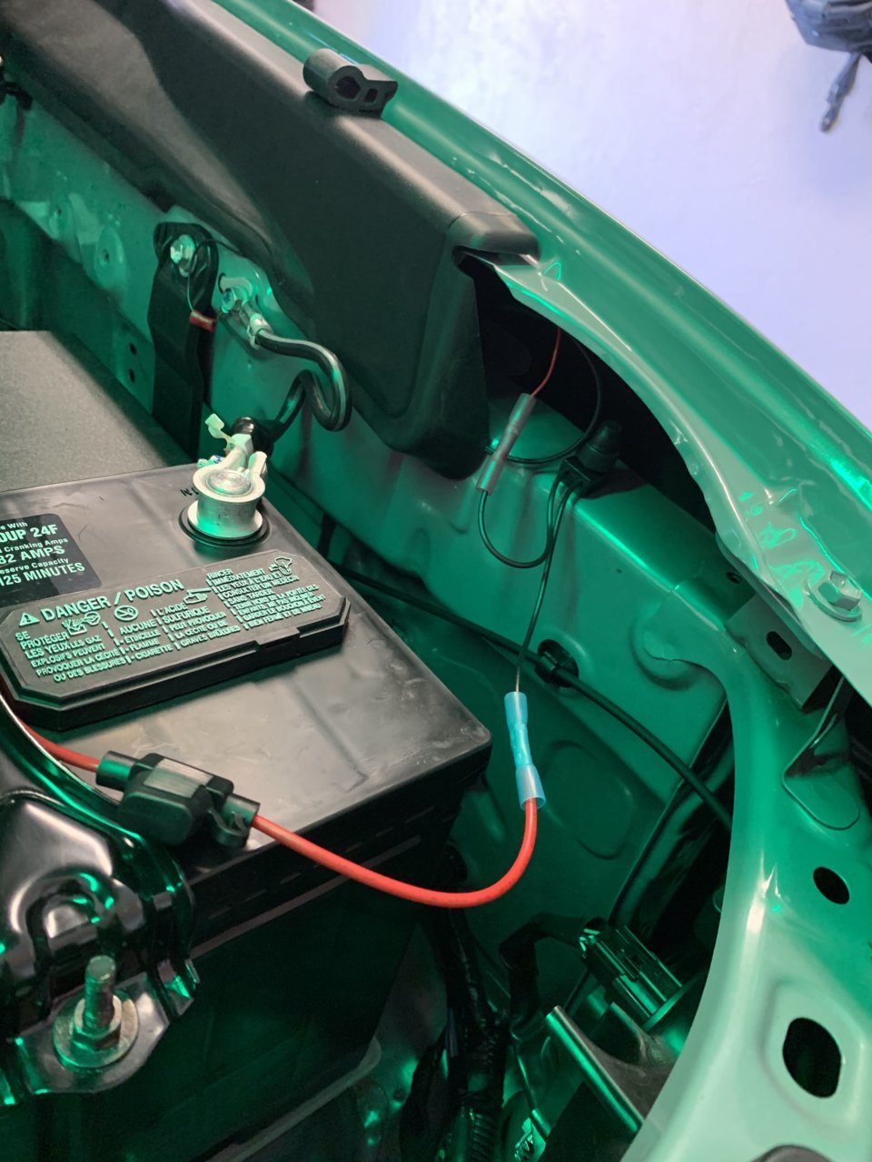

    Woke up to get a couple more pics and I keep blowing fuses, any suggestion?
    5 and 10 amp fuses keep blowing.

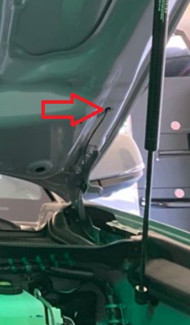

    Taking a closer look at your pictures, I'd check for chaffing right there:

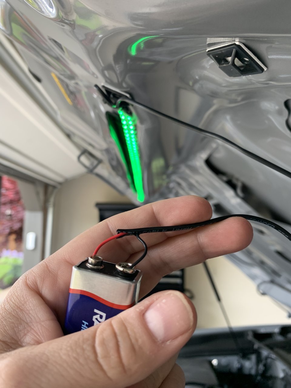

    I just hooked the lights to a 9 volt and it works just fine.

    Here is the 9 volt.

    Great. Still works then. Try adding the switch to it.
