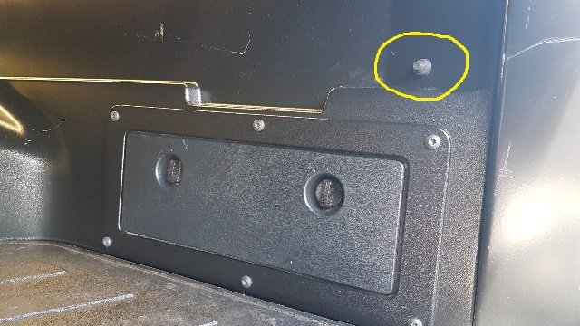

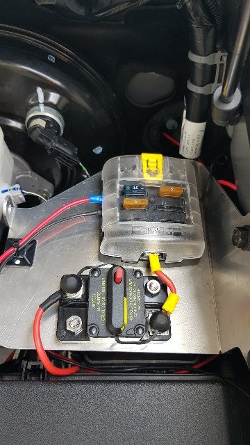

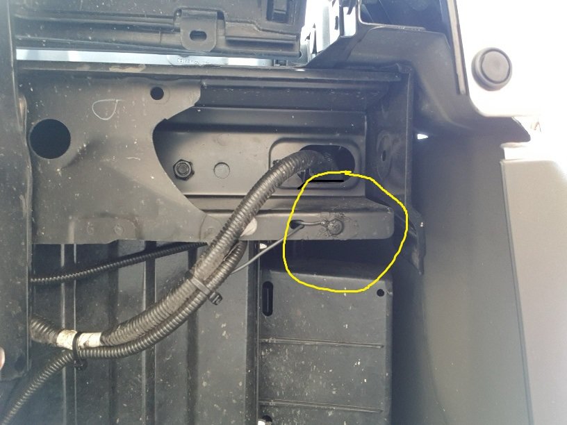

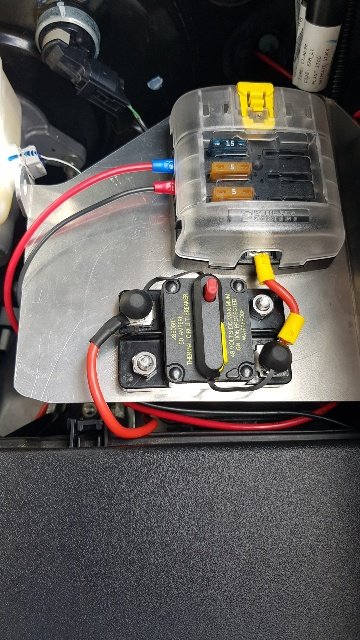

    Install is quite easy, I also am running a Blue Sea fuse box and breaker for the additional connections. I still haven't mounted my hood lights but I should have time tomorrow. I'll clean up the fuse block wiring as I left the excess wiring in case I need to do some additional wire routing. I mounted my switch in a different part of the bed and the ground also in a different location on the crossbar at the end of the frame rail. Came out well.

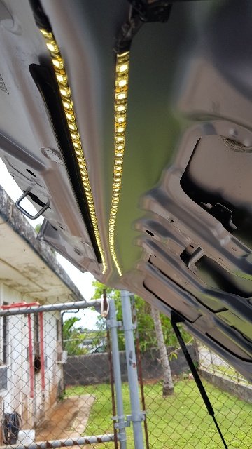

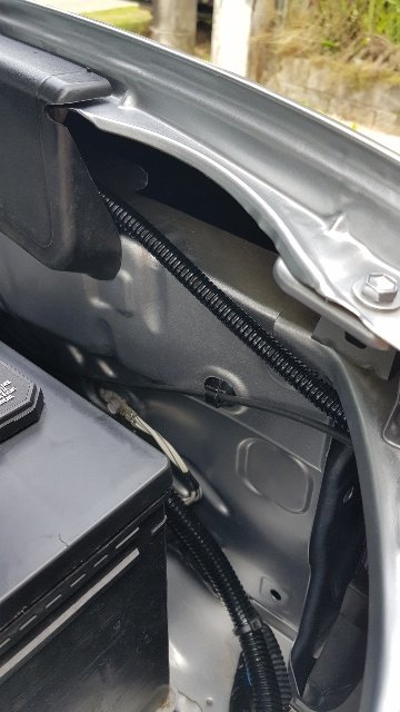

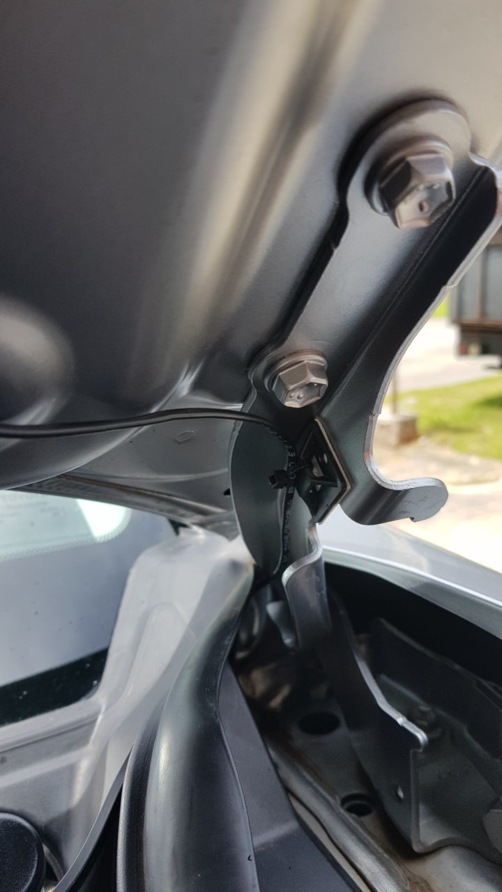

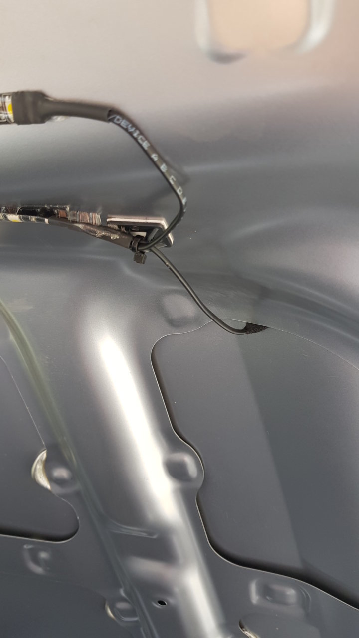

    Thanks! Now I just finished the hood lights. I will have to say, don't do this if you are in a rush, you'll see why in my last pic. I ran the power wires inside the driver side hood panel and routed by the hood hinge and under the cover. I used tesa tape and wrapped the wire to make a friction fit for the wire under the hood supports. Ran it under the fender panel and mounted the switch in the blank hole by the headlight, perfect fit there. Used the leftover wire from the bed kit and used that to wire up to the Blue Sea fuse block for positive connection. Used the factory ground bolt for the ground, I stripped an inch off the ground wire that is paired with the red wire and folded it over 4 times to make it thick enough to crimp on the ring terminal I used for the ground. Tied everything up and connected main power. All good except for my applying the actual lights. Like I said, don't rush and have someone help you line them up. I cussed myself out when I looked from the side, but I got my lights in there. I had to rush as I work in about 2 hours from this post.

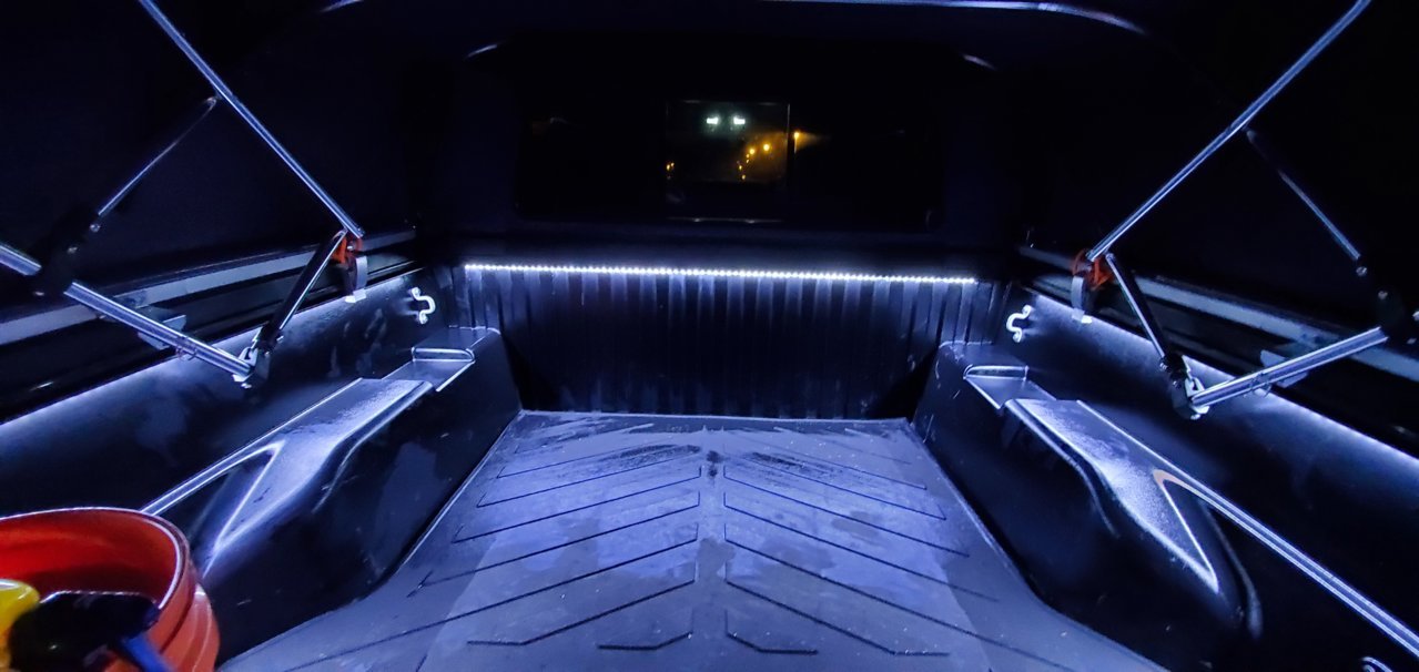

    Love how it turned out. Price is well worth the kit. Now I want to look into adding an additional button inside the cab to turn the lights on in case I cannot reach the button in the bed.

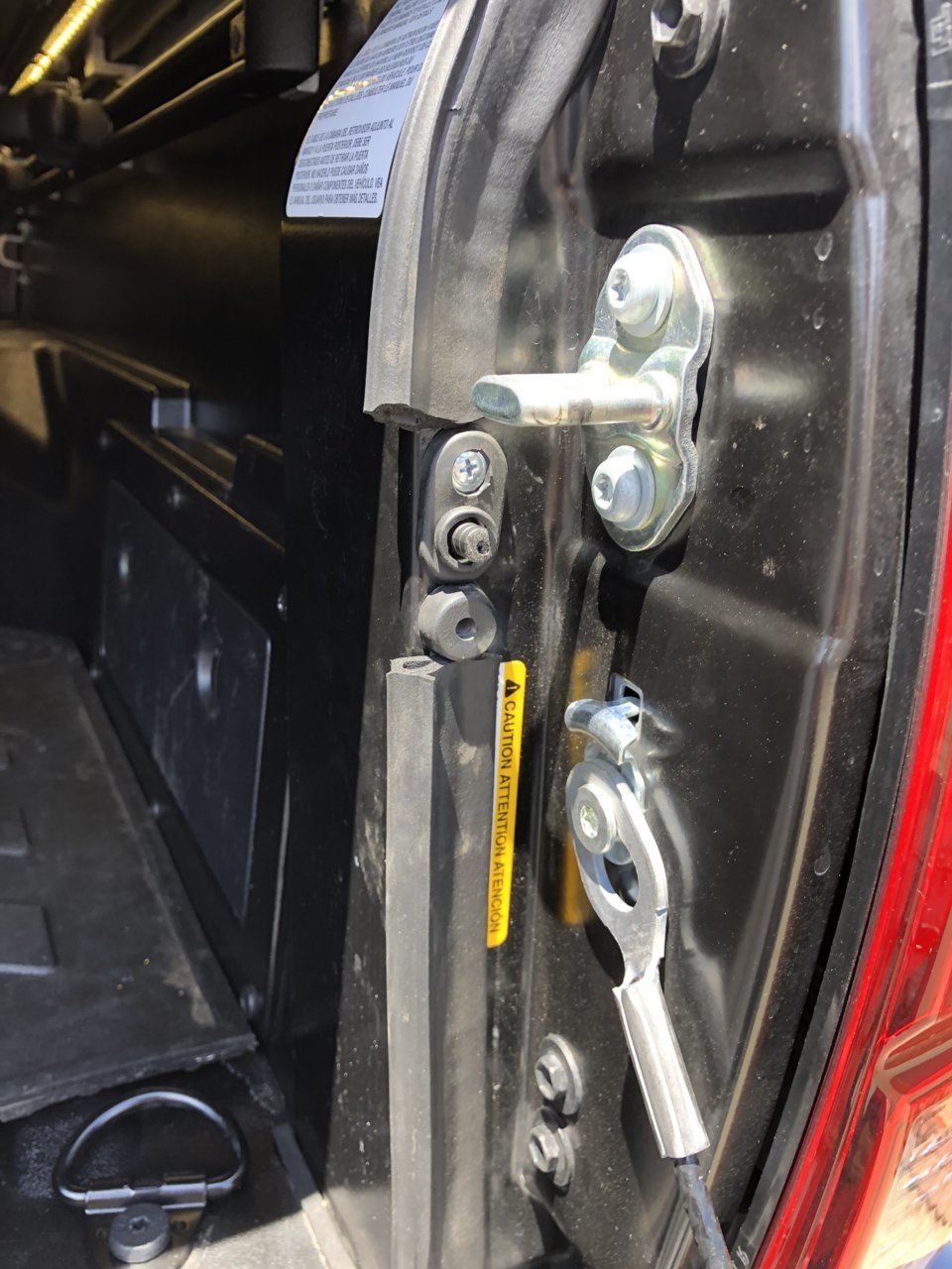

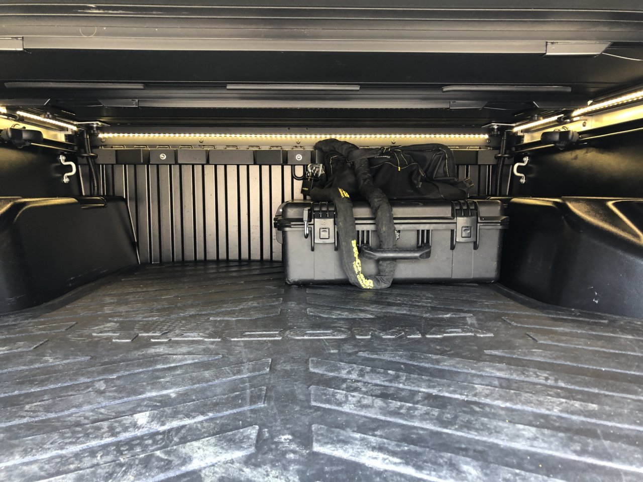

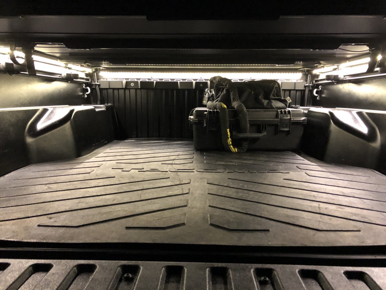

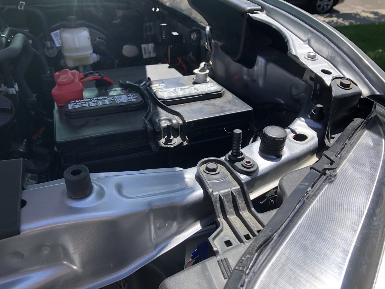

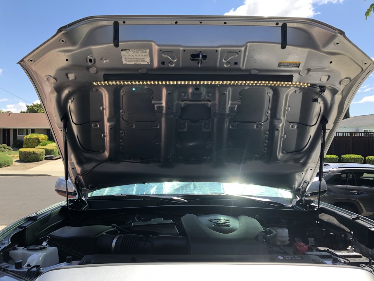

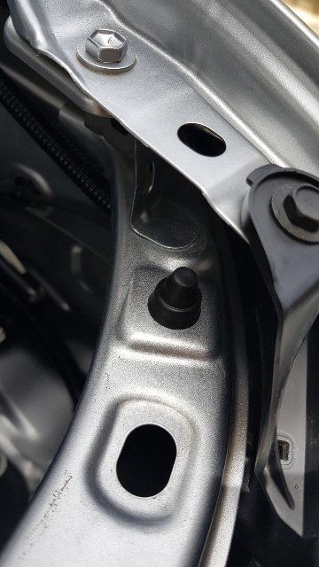

    Tailgate ground pressure Switch
    Under hood ground pressure switch

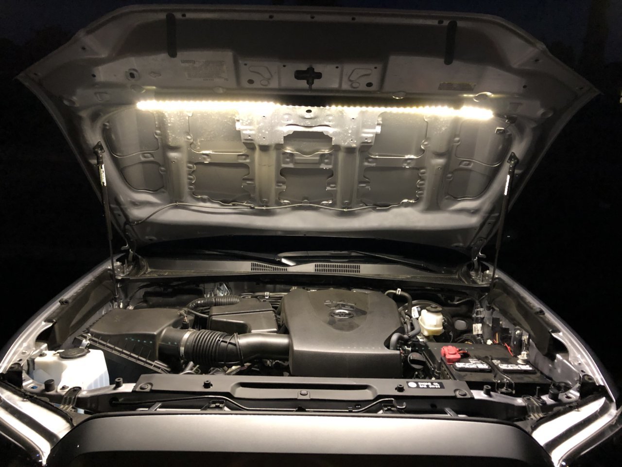

    Yesterday I wired up the Bed and Under hood lighting kit. Came out real slick. I added in a ground button switch I bought off eBay so the lights turn on as soon as I drop the tailgate and pop the hood. Also wired the manual switch on the power side to turn them on and off manually. I’ll edit in some better photos in the night time.
    Here’s the ground Switches I used.
    https://www.ebay.com/itm/400963658762

    Looks good, man... thanks for sharing. Did you have to drill holes for your ground switches?

    for the one in the tailgate area yes, as well as a hole for the manual on off switch. I also had to pull the brake light out to access the wiring. For the hood area I used an existing hole and only had to drill the mounting hole for the hardware bolt. I was able to use my Gopro with live view and close the hood before mounting it to determine that it was infact long enough to contact the hood when closed to break the ground connection. So far both switches have been working flawlessly. We'll see how long they hold up.
