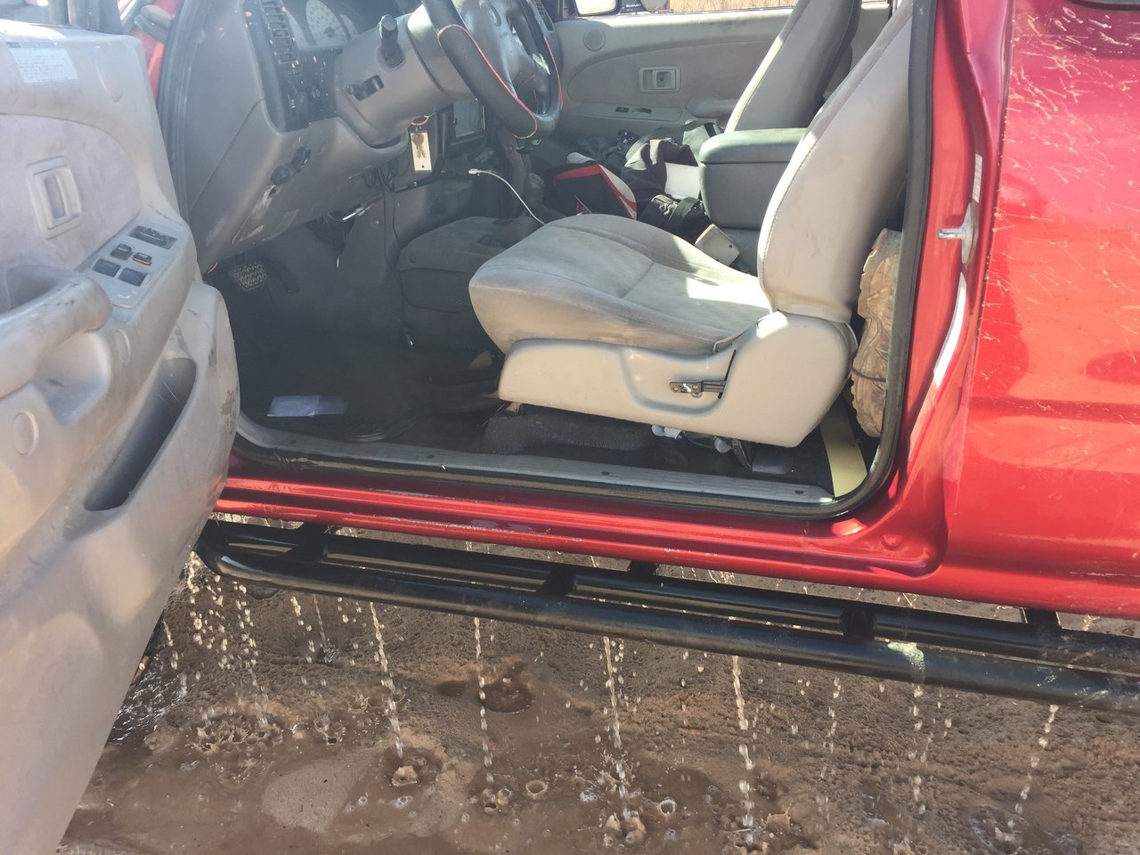

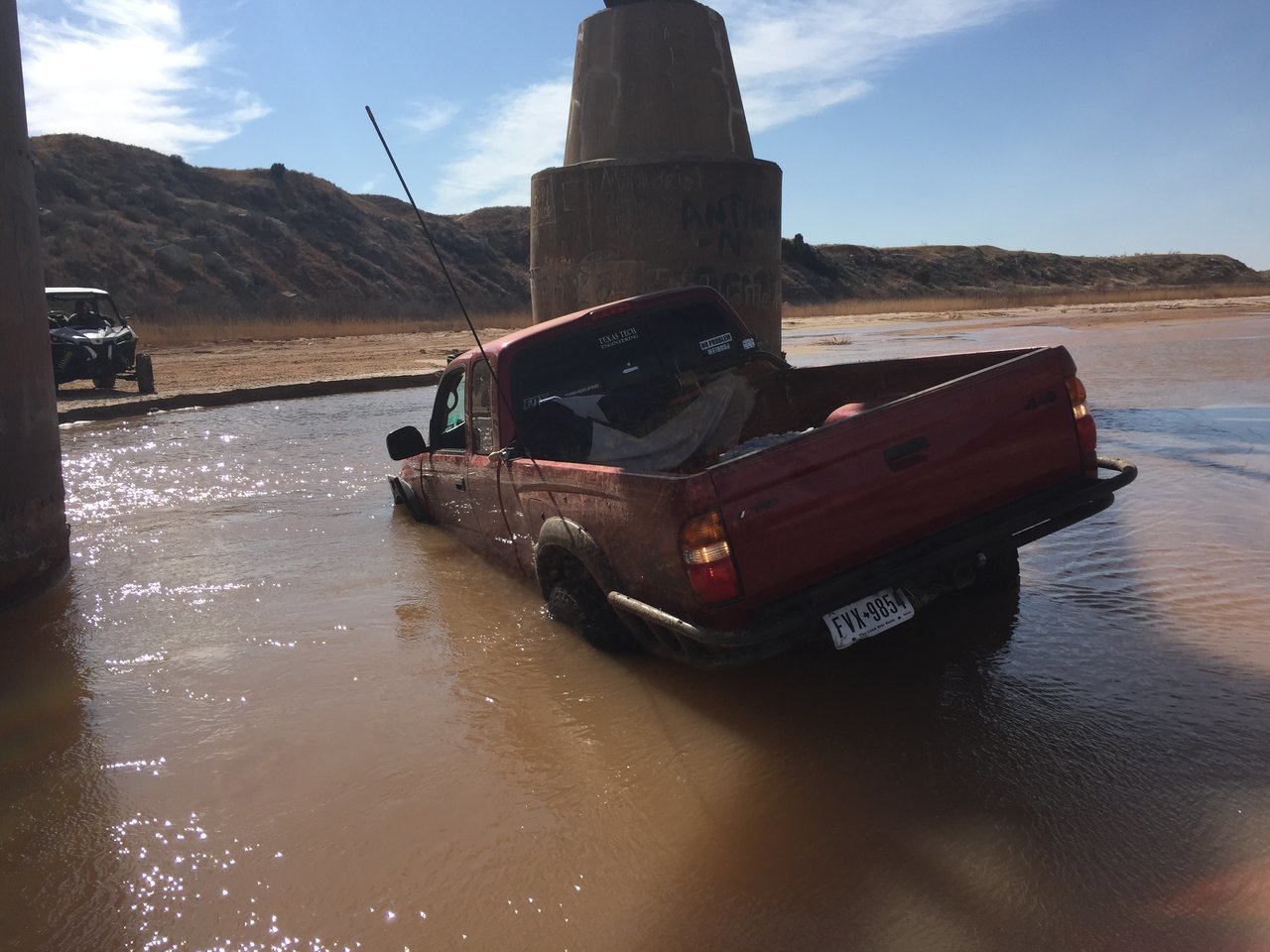

    So I did this. The horn wouldn't turn off. Got yanked out and disconnected the battery for 20 minutes or so. Truck wouldn't even get the starter to click but dash lights would come on. Pulled off a wire with a white wrapping off the positive battery terminal; every time it would touch the positive terminal it makes this super high pitch screaming sound. Was able to get it started by touching that wire and turning it over at the exact same time. It ran and drove fine, but while driving, even with the white wire disconnected, it continued to make that screeching sound. The horn would also randomly go crazy. I got back to camp, turned it off, now it's dead again.

    Horn was on the uo side when I sunk the truck. And don't know how that would keep it from starting. With the horn fuse pulled in video 2 you can still see the noise the fuse wire touching the battery makes
