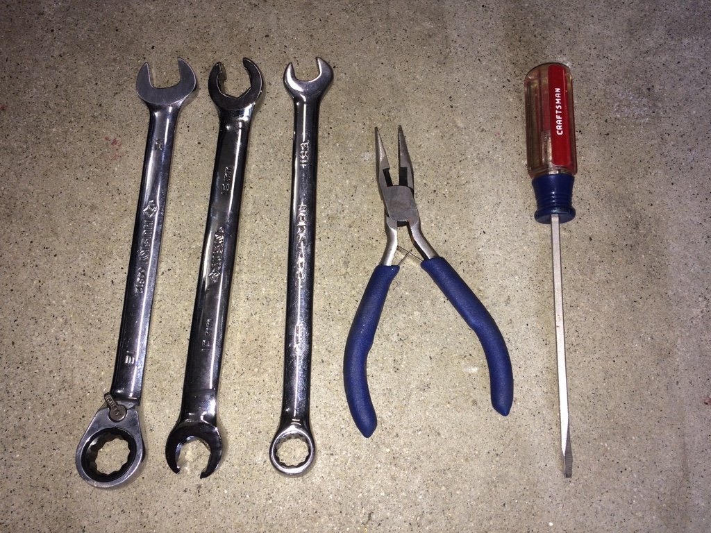

    Just did this today...here's a couple pics:
    Tools I used...not pictured was the 24 hour soak of my nuts ;) with PB Blaster...

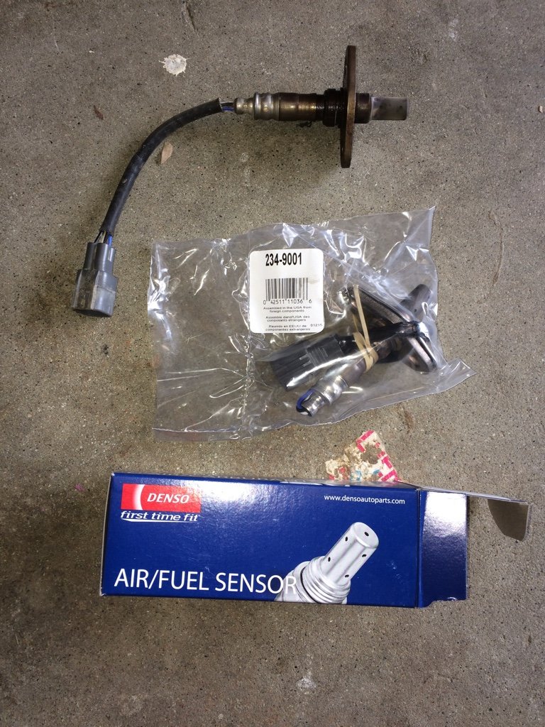

    Old and new...

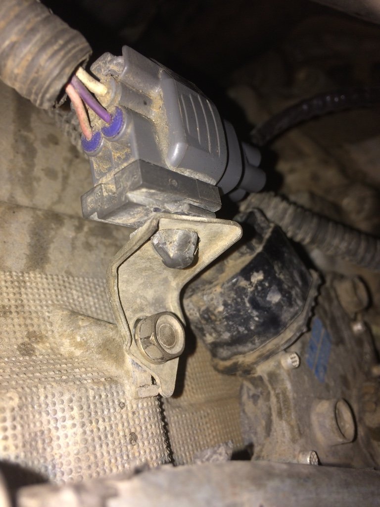

    Removing this 10mm bolt and bracket from the trans really helped to unplug the sensor...

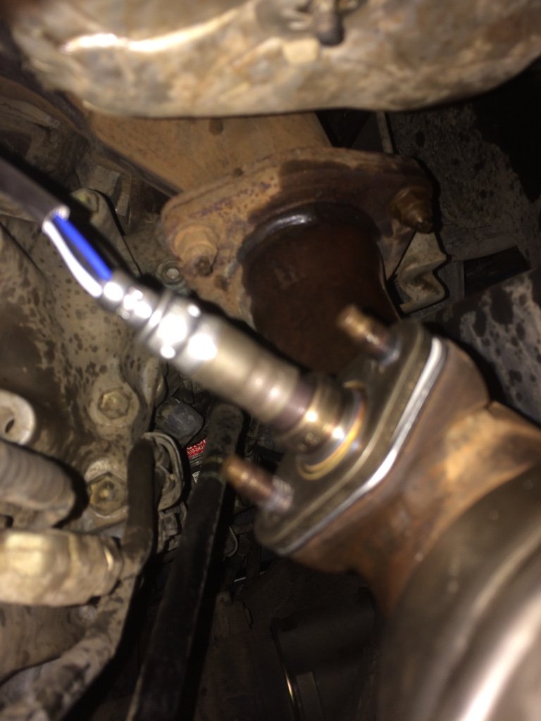

    New sensor and gasket in...
    All good, now on to the OBDII scan reset.
