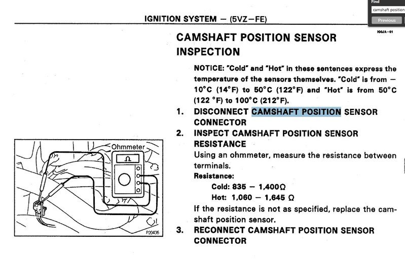

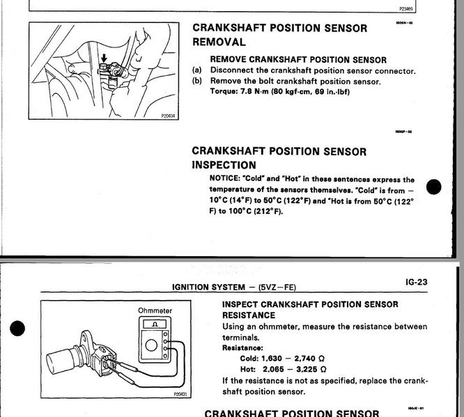

    I would be checking cam and crank position sensors.

    K I'll try that tomorrow and let you know thank you

    Can and crank sensors good. It runs for a couple min then dies. Let sit for a couple min then starts back up.
