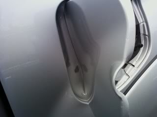

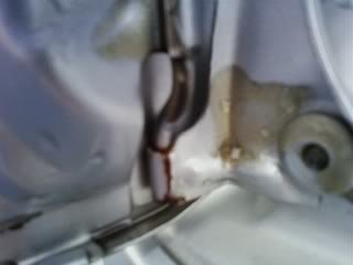

    My fuel door started rubbing the paint on the truck (left side of fuel door as I'm opening it) and creating a spot near the gas cap where it hits. It's a noticeable grinding as I'm opening the door. I had the body shop at the dealer look at it today and he pointed out that the bottom hinge looks cracked and is rusting. Like it was forced and broke.
    Not a big problem really besides rubbing off the paint might cause it to rust near the gas cap. Also, the door will probably fall off eventually.
    I know that the fuel doors on these Tacomas have had a few problems with rust and falling off. It seems to me like the bottom hinge on mine rusted and is cracking the hinge, creating this problem. I'm at 57000 miles on my truck. Do I have a case to get this covered under the 5yr 60000 rust warranty? Does anyone have experience with this?
    I got quoted at $147 to replace and paint a new fuel door.

    I had the same issue. I sprayed the hinge with WD-40. It removed the rust and has kept the rust from returning. Spray it once a year.

    Mine did the same thing....rubbed the paint, bottom hinge hosed.
    My dealer fixed it before my 3/36 ran out.
    A few folks here & on TN have had the same issue.
    I do the same as steivietyles does & keep an eye on it....
    A couple of posts I have seen around that bottom hinge snaps off..

    I sprayed some WD-40 on it. At the least I hope that the hinge doesn't fall off on me. I can live with a crappy fuel door but I don't want to have to pay for a new one.

    My truck is doing this now too. 15k miles on mine. I don't jam the door when i open it so this hinge must really suck. I fixed first time by bending back with long screw driver but its back. Any better ideas? It is the lower hinge.

    I ended up using wd-40 on it. Doesn't rub any more and hasn't came back yet.probably have to lube it once or twice a year. Also good preventative maintenance for anyone who doesn't have this problem yet.
