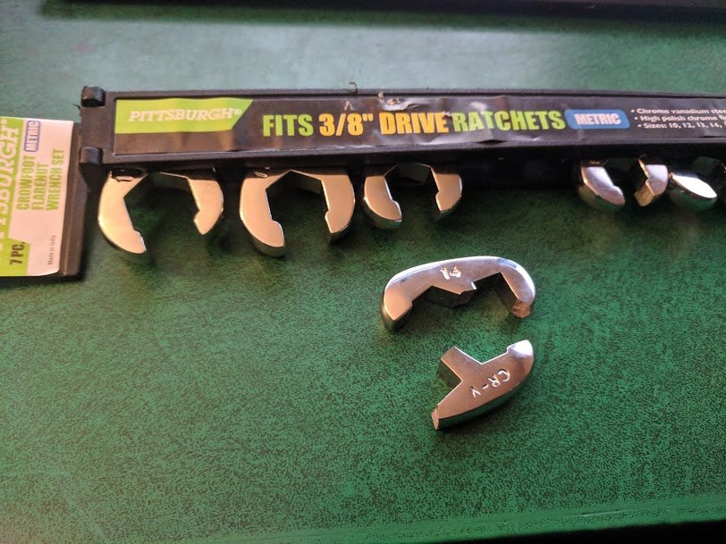

    Cool, I won't worry too much about it then. My flare nuts look like they have good edges and the filter body itself is quite weathered, so I imagine my filter is factory original with 170k miles on it. I'll see if I can get some "quality" chinesium flare nut wrenches from the Horror Fraught and tackle this next weekend. Camelback seems to have prices competitive with parts from Amazon (which are probably 50/50 OEM/counterfeit).

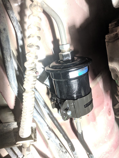

    Easy-peasy lemon-squeezy. Used 19mm open wrench on the filter nut and 14mm crowsfoot wrench head on the flare nut. Had to wiggly and jiggle and bend quite a bit to get old one off, but getting new one in was easier. I left the gas cap off overnight and NO fuel came out after backing out the flare nuts. It was only after I started trying to remove the filter body itself that fuel spilt out. Also I think the filter I replaced @ ~170k must have been a replacement because the fuel that came out of it was crystal clear & clean. Oh well, at least I don't have to worry about it.
    I put a little motor oil on the end of the pipe flare and on the flare nut threads. Torqued to 21ftlbs. IN did not leak but OUT had a bad leak, so I backed it out, threaded it back in and applied much more than 21 lbs of torque to stop the leak. Oh well, probably won't be replacing this thing ever.
    There was a causality while torquing the OUT flare nut
    That's how you know you tightened the flare nut enough.
