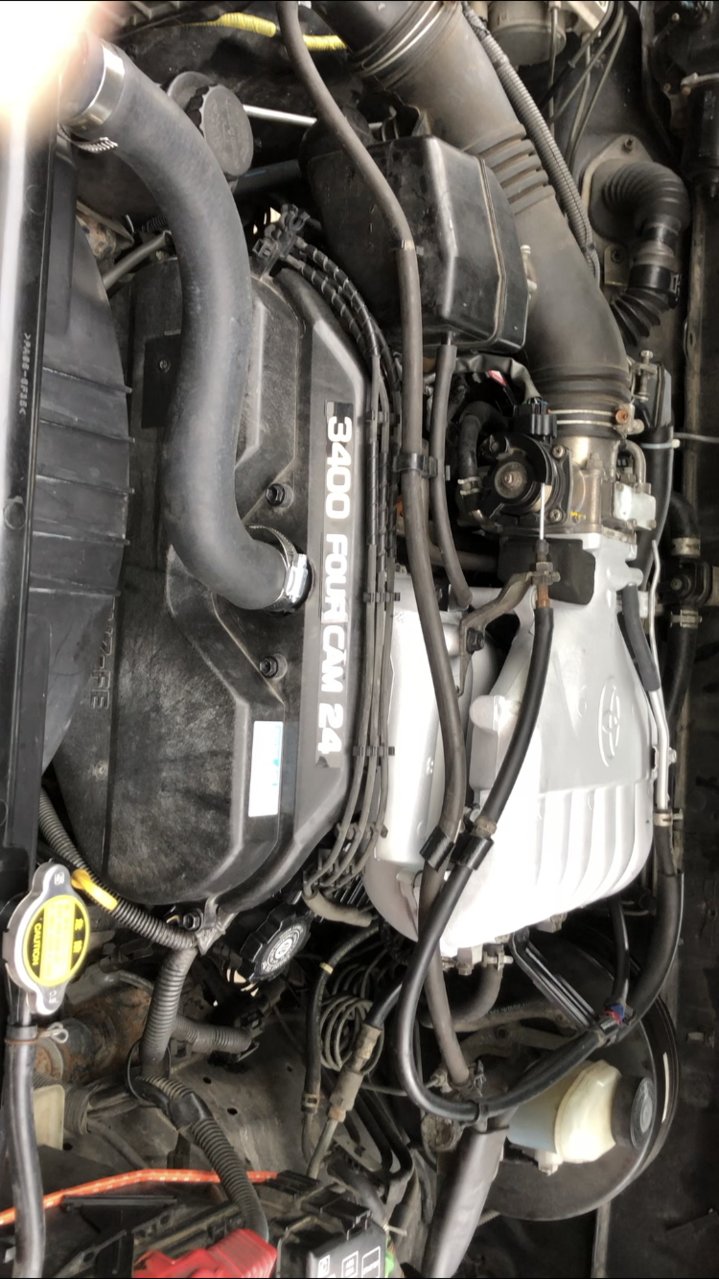

    have you ever cleaned you MAF sensor?

    Replaced less than 10,000 miles ago!
    Throttle body cleaned during fairly recent valve shimming and valve cover seal replacement
    No codes!
    I’m sure a code will come soon though...
    Until then I’ll look everything over.

    Cleaned up and replaced all I could around April.

    OEM or aftermarket MAF?
